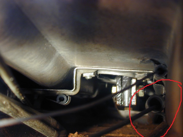

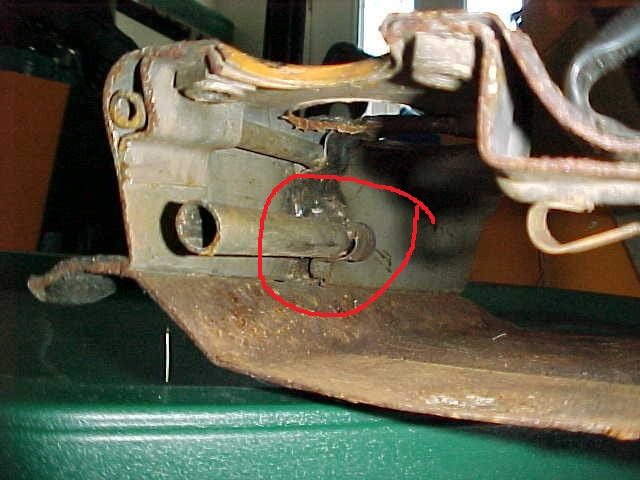

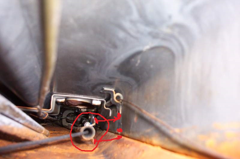

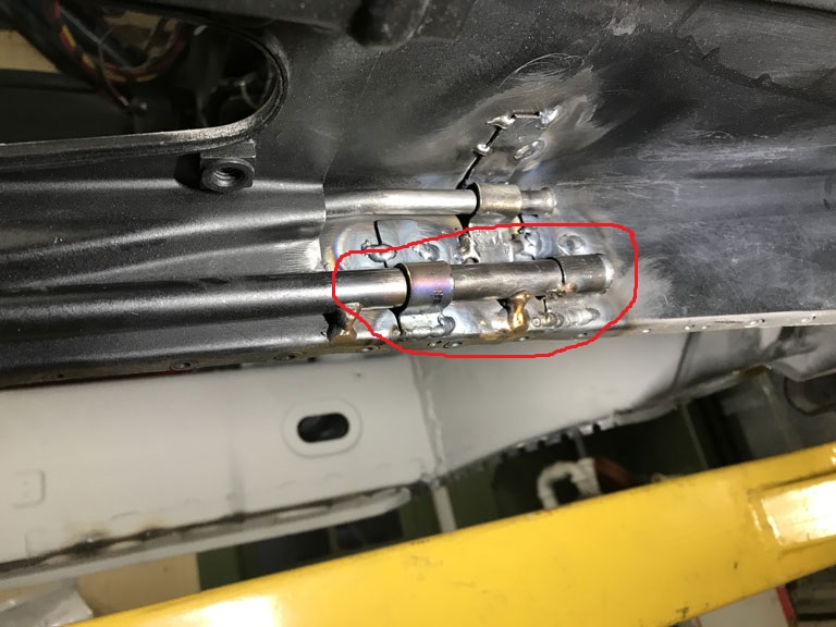

If so, then the other area is within the tunnel itself. Here are a few pictures I collected of the inside tunnel:
Here is a what it is supposed to be. This view is looking toward the back of the car.
Here you can see how the tube has detached from the driver side of the center tunnel.
Another shot of the tube being attached to the wall. Now looking towards the front, the tunnel having been cut at ~shifter level.
Here this one seems to have been repaired with an extra clamp too.
I had to repair mine but unfortunately I don't have pictures of it. What I did was to drill a couple of holes in the side tunnel where the u clamp is touching and I plug welded it. I was able to push back the tube in place via the shifter opening. Not sure this description is clear... (IMG:style_emoticons/default/dry.gif)

QUOTE(Montreal914 @ Nov 10 2023, 08:31 PM) *
First look at the rear firewall to see if the end of the tube is solid there.
Ok....I am starting to get it....I bought a borescope this week so I will give it a good look tomorrow.....the three A's as we say.....awareness-acceptance-action....who boy!!! Action should be a new experience!!
