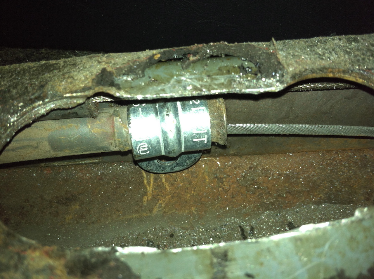

My clutch tube was completely detached at the front end, so I cut an access hole in the tunnel and fashioned a clamp made from an electrical clamp part. Bolted on with 1/4" bolt
I also had to re-weld the tube at the firewall.
