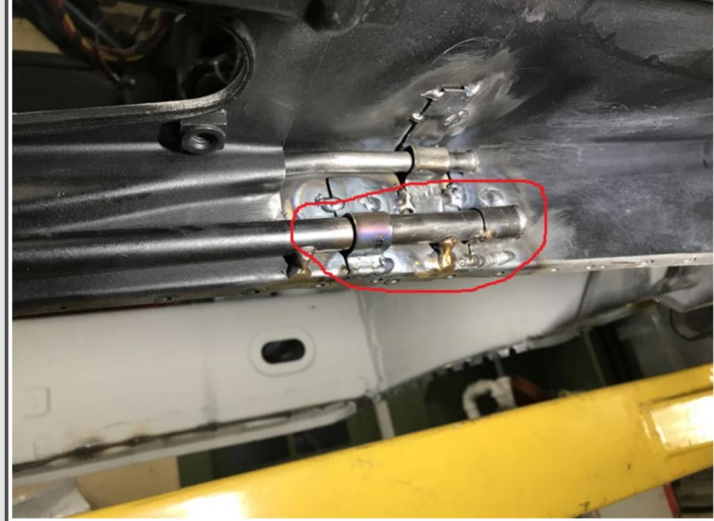

This one is mine
Tunnel was transplanted from a different parts car into my rustoration. Control tubes were fabricated from new metric tubing from Restoration design.
The clutch tube anchor is overkill. Belt + two pairs of suspenders (IMG:style_emoticons/default/lol-2.gif). Two welded brackets + a couple dabs of braze above and below the tube directly to the tunnel. I wanted to make sure it never has to redone in the next 50 years because it’s such a miserable job to fix when it breaks loose up there.
