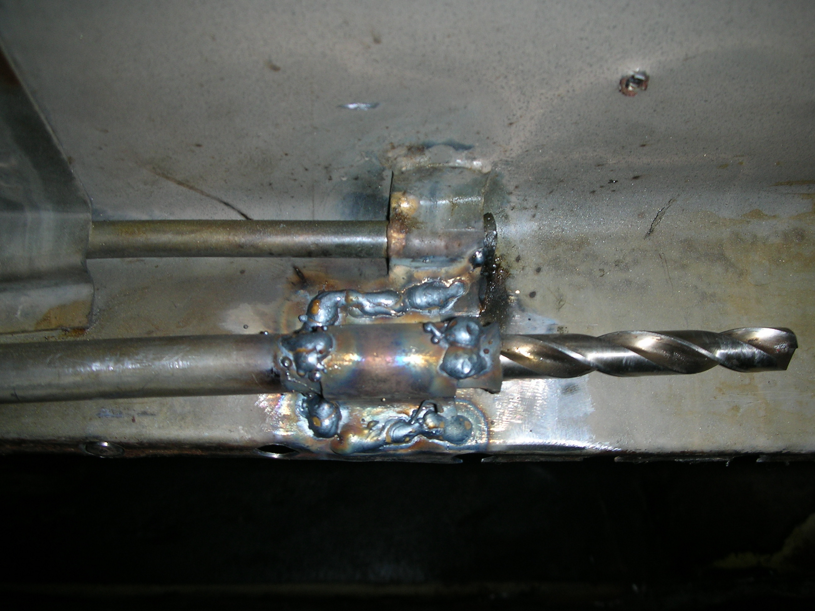

R/R the shift lever assembly for access. Put a #2 phillips screwdriver in the end of the tube to stop the weld, drill holes then plug weld the tube to the side of the tunnel from the outside. No need to cut the tunnel.
The front tube repair in my 6. Put a drill bit in so the weld would not blow through
