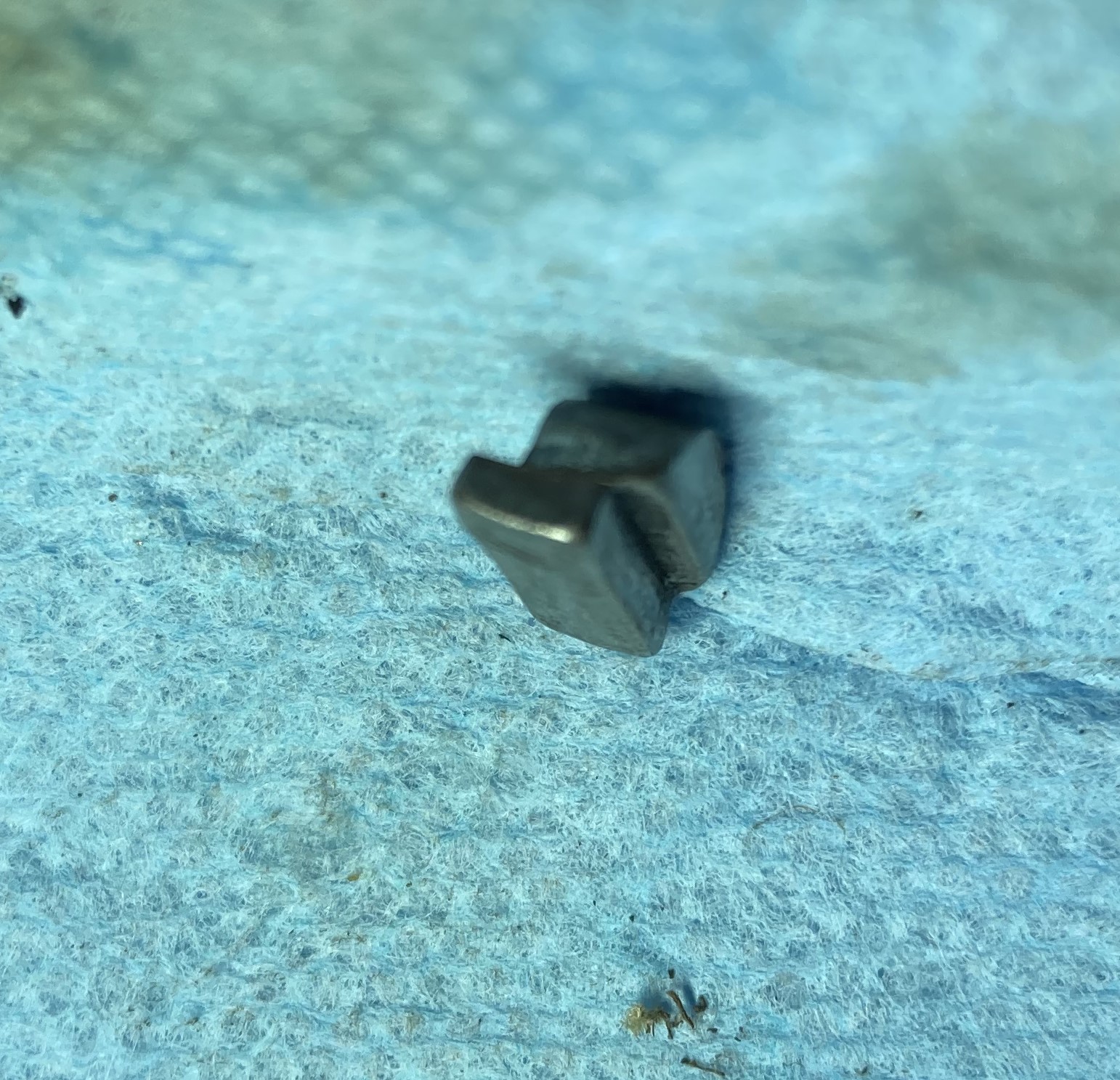

I was cleaning up the garage yesterday from the mess I made with this project. Came across the old pulley hub (with its slice of key still in the groove) and decided to add it to my "wall of shame" of failed parts I have (when you get into racing you tend to collect stuff like this).
On the shelf, I picked up the broken crankshaft from 2019(?) and was going to slide the hub on there but the crank still had a key in it; I tapped the key out and noted that the key was damaged, offset like the old offset keys we used to use on VW overhead cams for timing. And there were scuff marks on the downstream side of the crank nose where its pulley was chattering.
So that engine's pulley was loose, too. I don't know if that was related to the crankshaft failure, but this certainly caught my attention.
