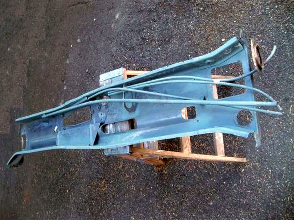

tunnel lines for your reference.

Superhawk996   :lol: This one is mine Tunnel was transplan...   Nov 11 2023, 09:50 AM
