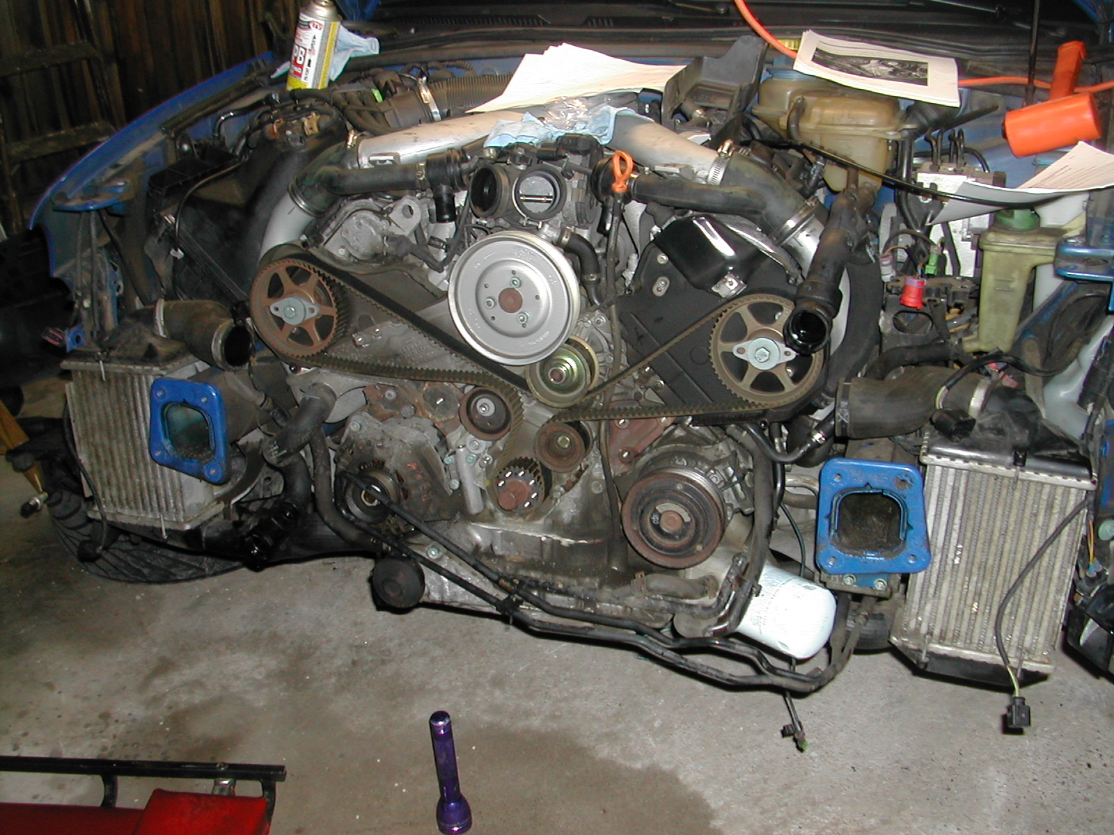

And that got my brain to remembering when I did my camshafts belt on my '00 Audi S4 at 100k miles, some 14 years ago. I remember that job with dread. The cam pulleys were taper-fit only, no drive keys. You'd set the engine to TDC and remove the tensioners and the belt, then loosen the bolts holding on the gears; you'd put the new belt and idler pulleys on and then setup this elaborate (rented) alignment tool with bars and pins that would locate all the engine drive components - crankshaft, camshafts, whatever was in there - at a specific rotation. And then you'd tighten the pulleys down to spec.
I remember thinking at the time that my entire investment in that car was wholly dependent on a bunch of taper-fit pulleys being properly secured by bolts...and if anything slipped I'd be funked...but nothing ever did.
Amazing how thoughts like that get buried away in your head, only to be exhumed at interesting times...
So ze Germans are still onboard with this taper fit thing even today. - GA

GregAmy   I was having a dinner conversation with a couple b...   Nov 21 2023, 11:08 AM
930cabman   I was having a dinner conversation with a couple ...   Nov 21 2023, 02:28 PM
technicalninja   The later model Audi with the direct injected V6 c...   Nov 21 2023, 09:37 PM
