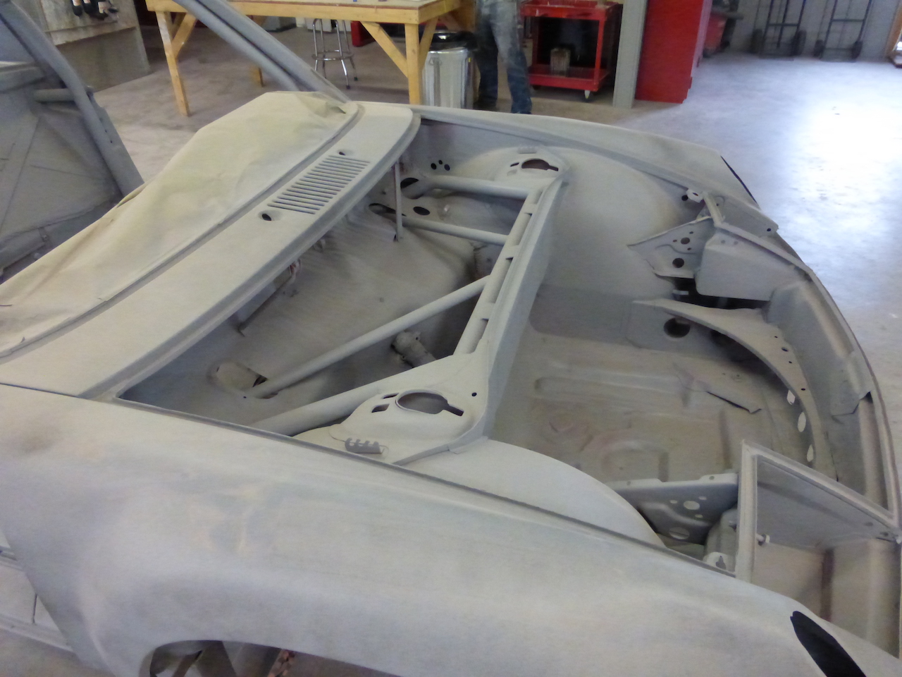

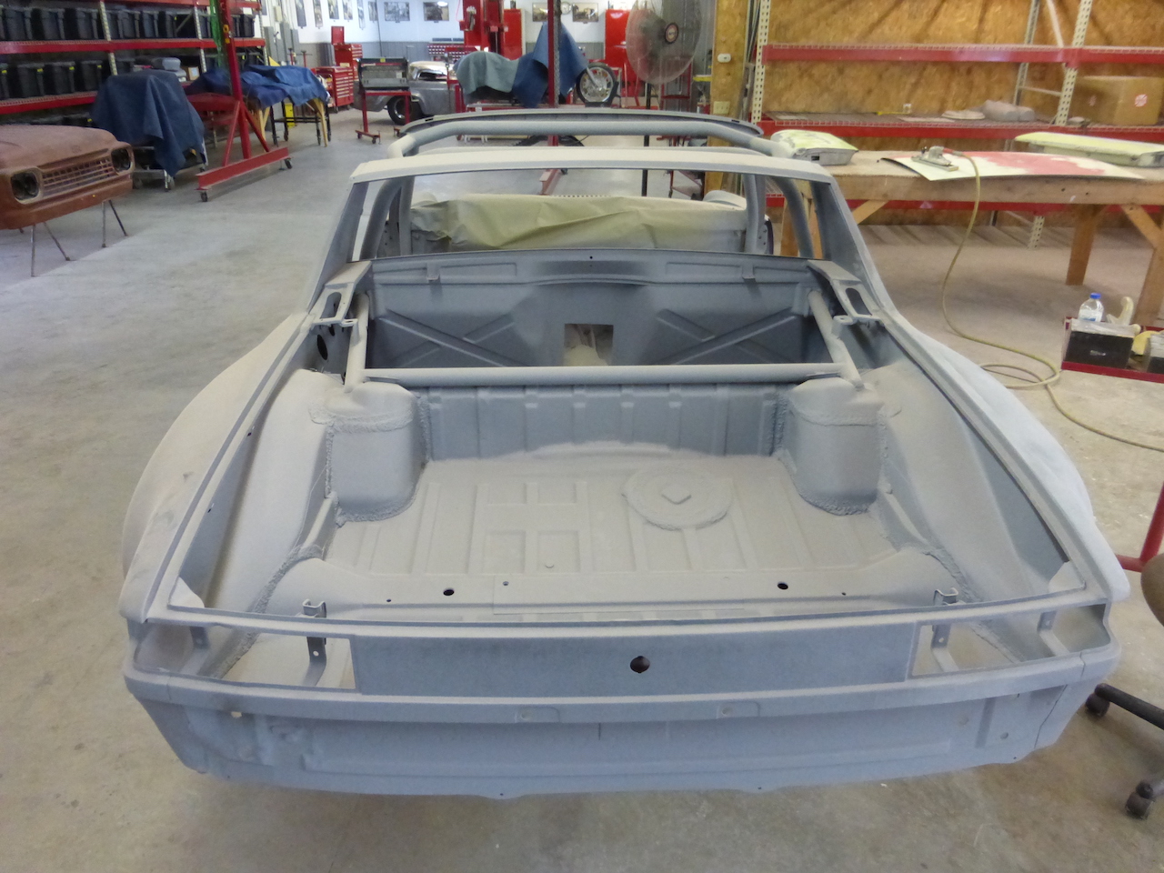

I had a full roll bar cage for many years. The last upgrade while building the 914-6 GT Tribute I extended to all suspension points.Attached Image Attached Image

QUOTE(mlindner @ Dec 1 2023, 03:35 PM) *
Nice work
The problem is that it’s not legal in some rules depending on class for wheel to wheel racing

mlindner   Thanks brant. Was not intended for full racing. D...   Dec 4 2023, 09:02 AM
