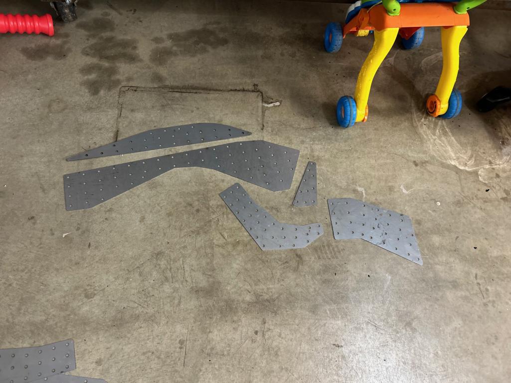

Car is back on the rotisserie to take care of a few things before sending off to media blasting.
Next task: Install the GT stiffening kit. I was debating on if this was worth it, but after talking with Eric Shea at Rennsport reunion at Laguna Seca, he's convincing me its a good idea if I'm going to run a 6cyl engine with wide tires. Who knows I may end up autocrossing or taking the car to the occasional track day so a few extra pounds of metal can't hurt.
Anyone have any tips/tricks or pitfalls to avoid?
Since the car already has the "outer longitudinal stiffening kit" installed, I don't think I'll be using the left piece of this kit.

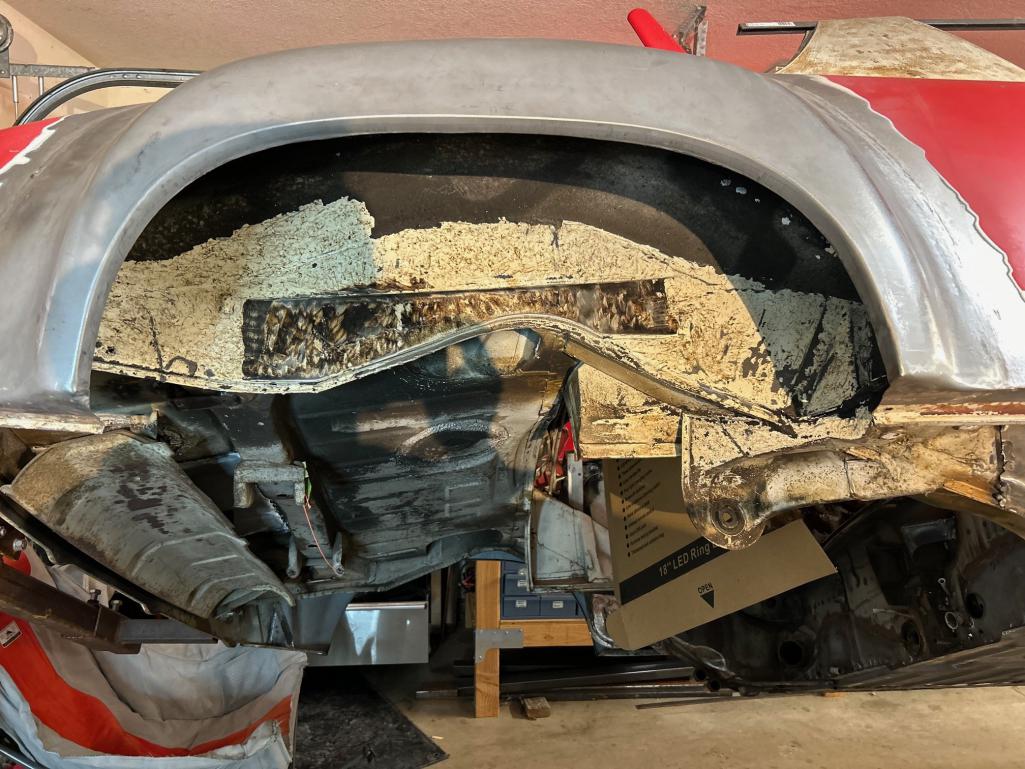

pencap914   Hi all, its been a while. Finally got to fix all ...   Oct 19 2025, 10:01 PM
tygaboy   Have you fit your wheels and tires so you know wha...   Oct 19 2025, 10:23 PM
pencap914   Raptor liner undercoating done. Car off rotisserie...   Feb 9 2026, 03:11 PM
