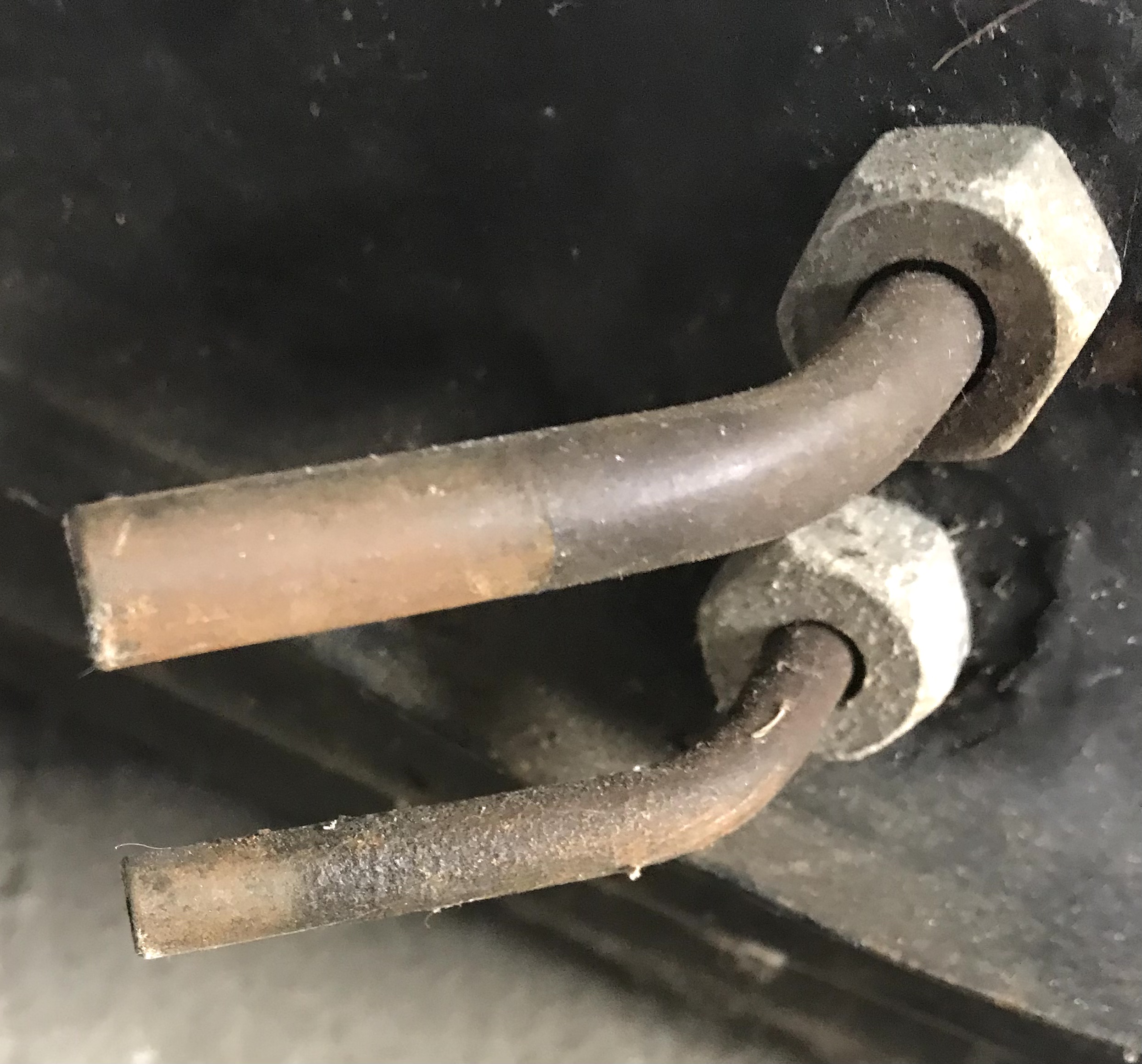

Hi Folks - I have the entire fuel system out of 9140431482 back to the Webers for update, cleaning, etc. (Webers already reinstalled after thorough cleaning.) The gas tank fuel outlet pipe has no hose bead.
Is this normal? Seems odd there wouldn’t be one.

Bottom of the gas tank from my 6.
Never been touched..
