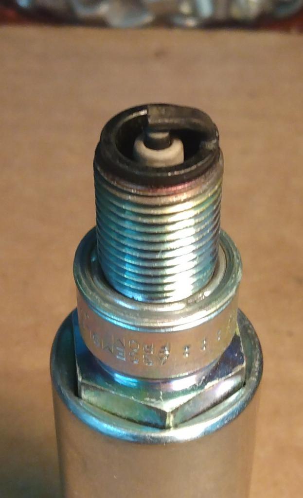

I am running a 50 mm Vanagon throttle body on my 2056. Moved the large wheel in the AFM 2 notches to get the AFR from 14.2 to 13.2.Attached Image

QUOTE(Geezer914 @ Dec 11 2023, 12:20 AM) *
Sir you are correct ,went thru my notes for VW AFM setting and found that I did change the spring tension on the wiper quadrant on the motor more than I mentioned .
What was your final cam choice ? , seems the PO may have an issue there as 914werke mentioned.
Appears the larger TB is a useful gain even on a mild engine ,I have the stock one and its pretty small.
(IMG:style_emoticons/default/beer.gif) .
