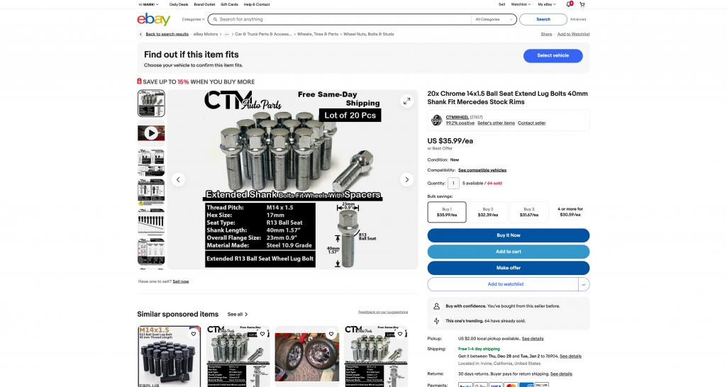

Bolt A has the correct flange (ball seat cup) and needs to be 40 mm.
Bolt B is totally incorrect.
Here is a more correct option. Factory bolts had 19 mm heads, these are 17mm.
