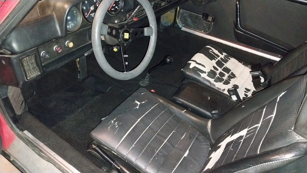

Finally got it driving over the Christmas break. Put in a Tangerine Racing firewall shift rod bushing and rebuilt the pedal with all new bronze bushing. New accelerator pedal and cable. Fixed my Pertronix Dist. With everything "hopefully" done i put in all the new carpet in as well. Aslo got my self a new MOMO Prototipo Heritage.
(IMG:http://www.914world.com/bbs2/uploads_offsite/i.imgur.com-26536-1705202230.1.jpg)
The rest of the interior can get done later and not necessary. But seat OBVIOUSLY need to be re-done. The back pad needs to be redone as well since there are two giant holes in it. Door cards need to be replaced since PO put speaking in them.
Radio needs to be fixed and speakers need to be put in.
Gauges need to be finished. Current set-up is my arduino on a bread board displaying on a little OLED screen. I have the design to make my own stepper motor gauges. Will have Oil Pressure, Oil Temp , and Cyldiner head Temp displayed.
However I have been driving it a good amount. Got about 350 miles on the new motor. Been super happy with it.
