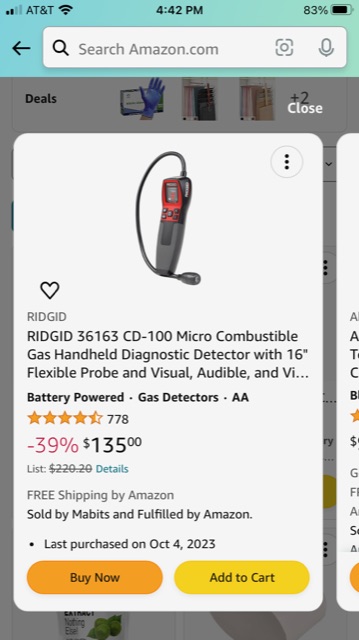

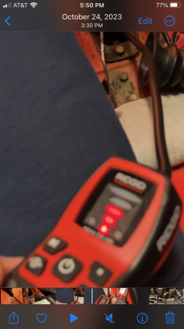

Resurrecting an older thread to add info.
This $135 Rigid sniffer allowed me to quickly locate the gasoline vapor leak PO’s two “experienced professionals” were unable to find on 9140431482. The greatest source was a SS braid hose; possibly due to internal rubber hose incompatibility with E85 gas?? Or maybe shift mechanism chafing the SS braid??? Just guesses. The SS hose routed thru the cabin tunnel. The leak found worst near the shifter.
And BTW: the “rubber patch” solution reported by PO in 2013 as a fix, failed the sniff test by women in my household.
