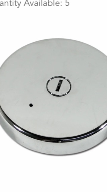

Below is a photo of what I ran on my ‘67 Vette for years. Tank venting was never a problem, and in the 5 years it was in the garage under bedrooms there was no gas smell. Note the approximate size of the vent hole; 1.5-2mm at most?

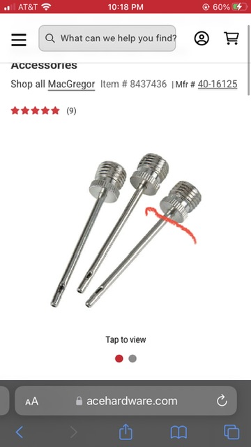

So I’m stuffing the cut off and deburred big threaded end of a ball (basketball, football, volleyball) inflator inside the vent hose. Will locate it at or before the uppermost point as vapors leave the tank / expansion tank and then travel downwards to where they exit under the car. Hopefully this will lessen vapor escaping thru the vent tube.

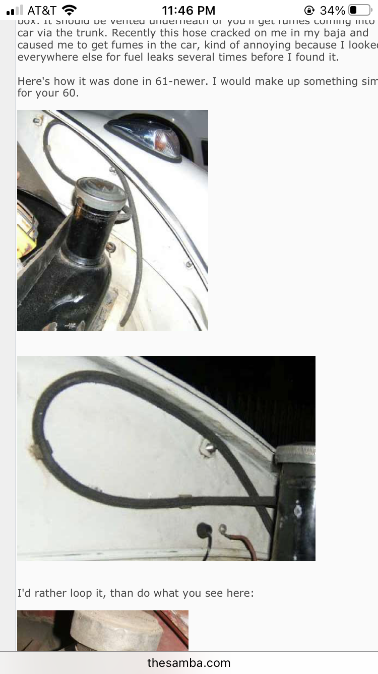

And this’s how VW configured the tank vent hose in Bugs of the ‘60’s (pic from The Samba), before evaporative control systems. By using the difference in density of air & fuel vapors as a natural check valve kinda like a kitchen sink drain trap in reverse
