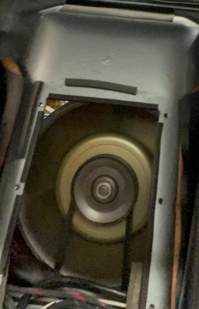

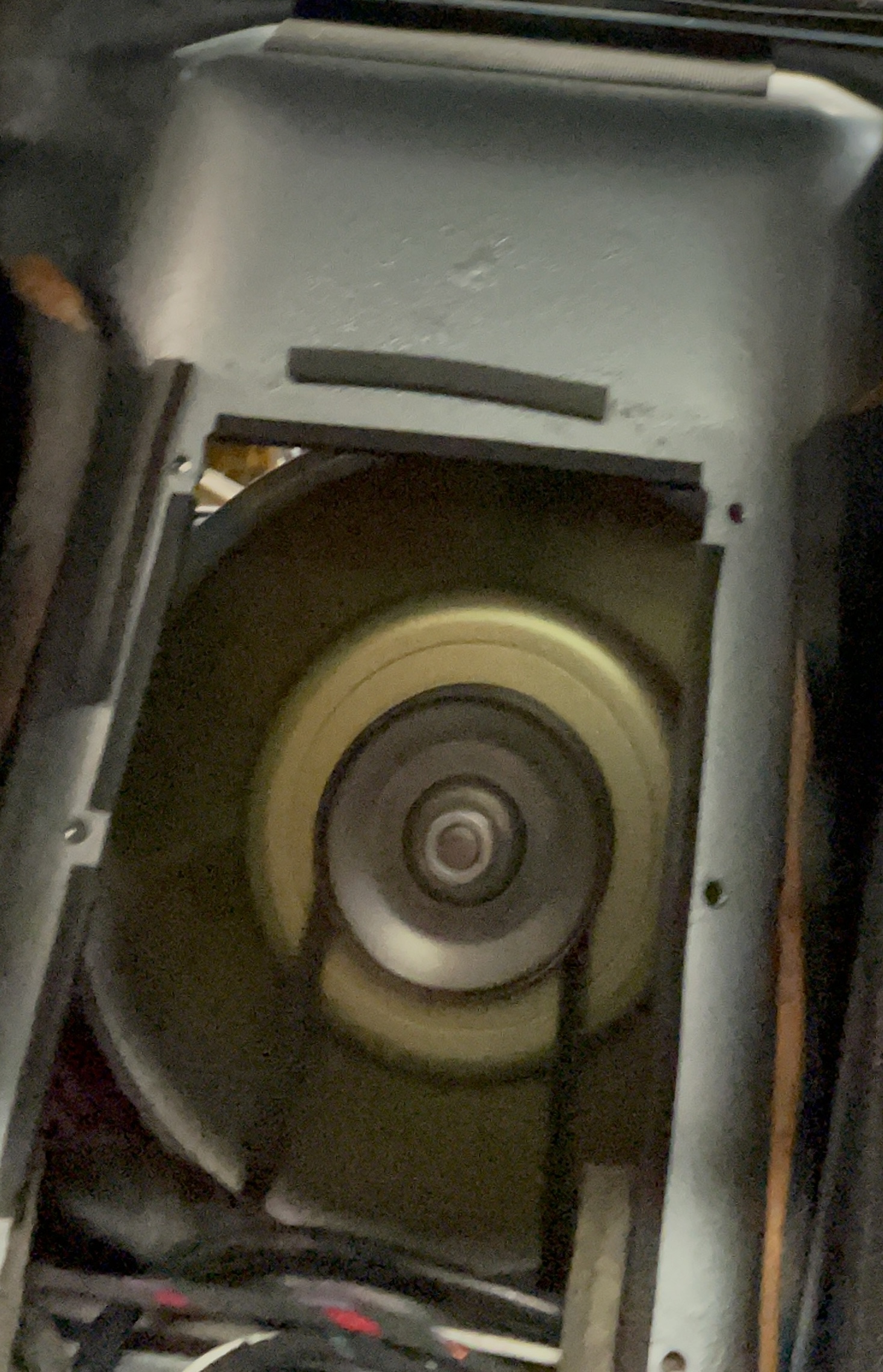

My version. Had a section from a donor car. Added weather stripping to inside of cover for noise/odor control. Works well, especially when I changed out the cast iron distributor for a 123.

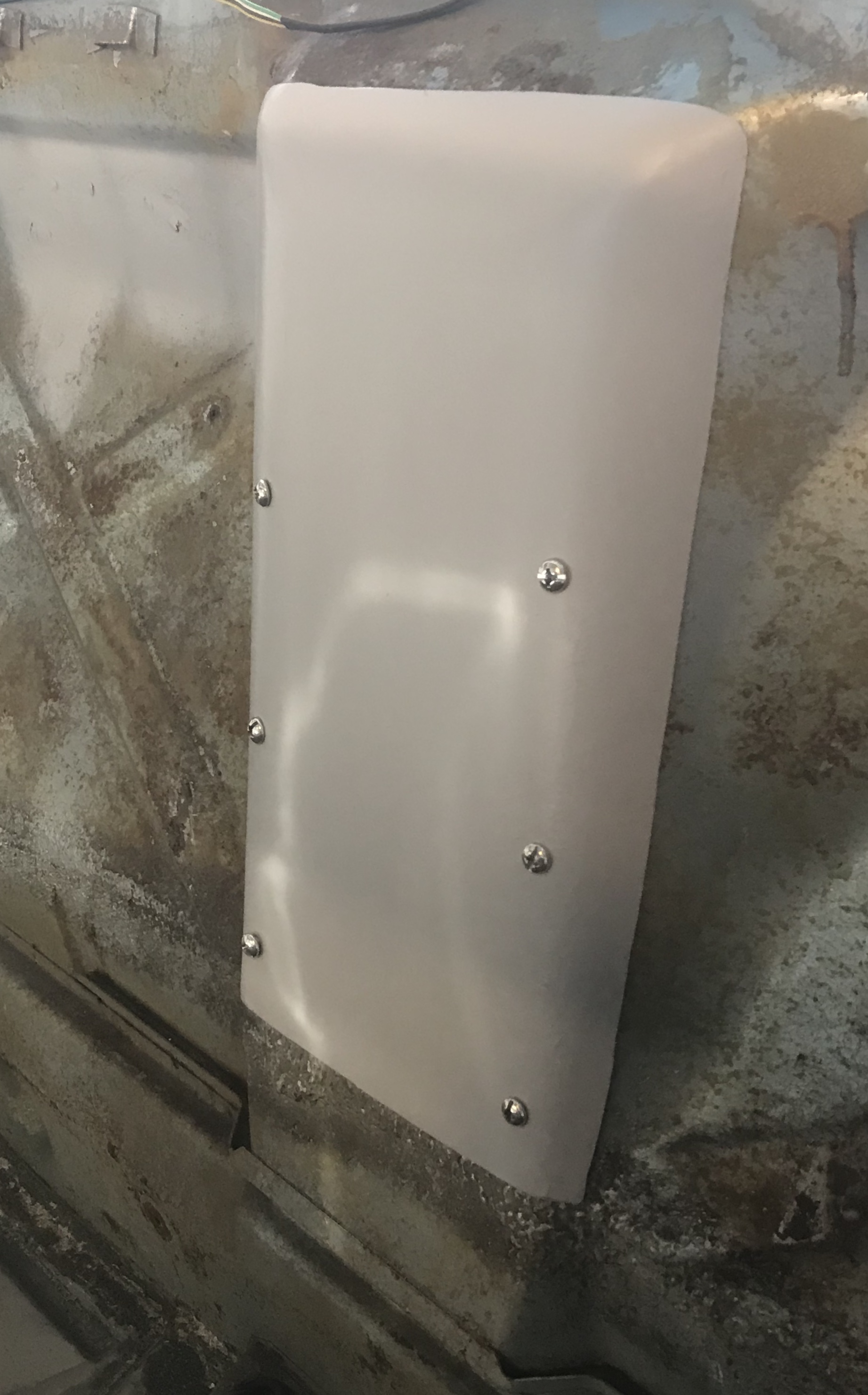

burton73   @morehills I have what you want. I was going to ...   Feb 29 2024, 03:07 PM

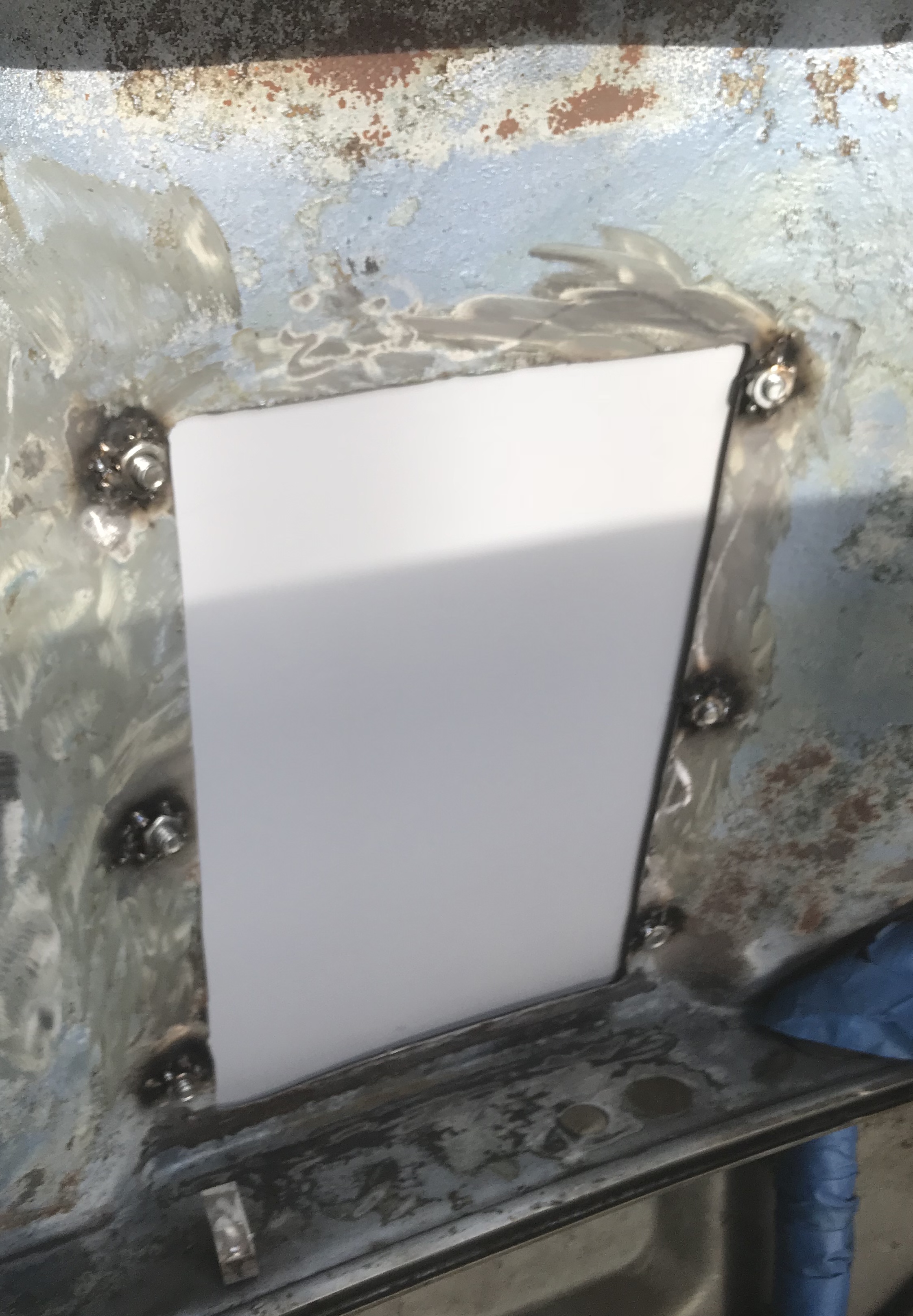

Mitox   I cut mine, and found a firewall section to make t...   Feb 29 2024, 04:56 PM
