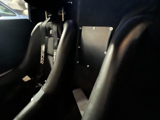

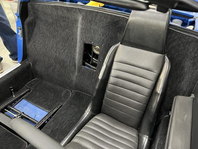

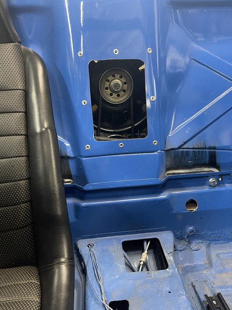

I’m with Team Firewall Access bay!!!!
(IMG:http://www.914world.com/bbs2/uploads_offsite/i.imgur.com-21443-1709511472.1.jpg)
(IMG:http://www.914world.com/bbs2/uploads_offsite/i.imgur.com-21443-1709511472.2.jpg)
(IMG:http://www.914world.com/bbs2/uploads_offsite/i.imgur.com-21443-1709511472.3.jpg)
(IMG:http://www.914world.com/bbs2/uploads_offsite/i.imgur.com-21443-1709511472.4.jpg)
