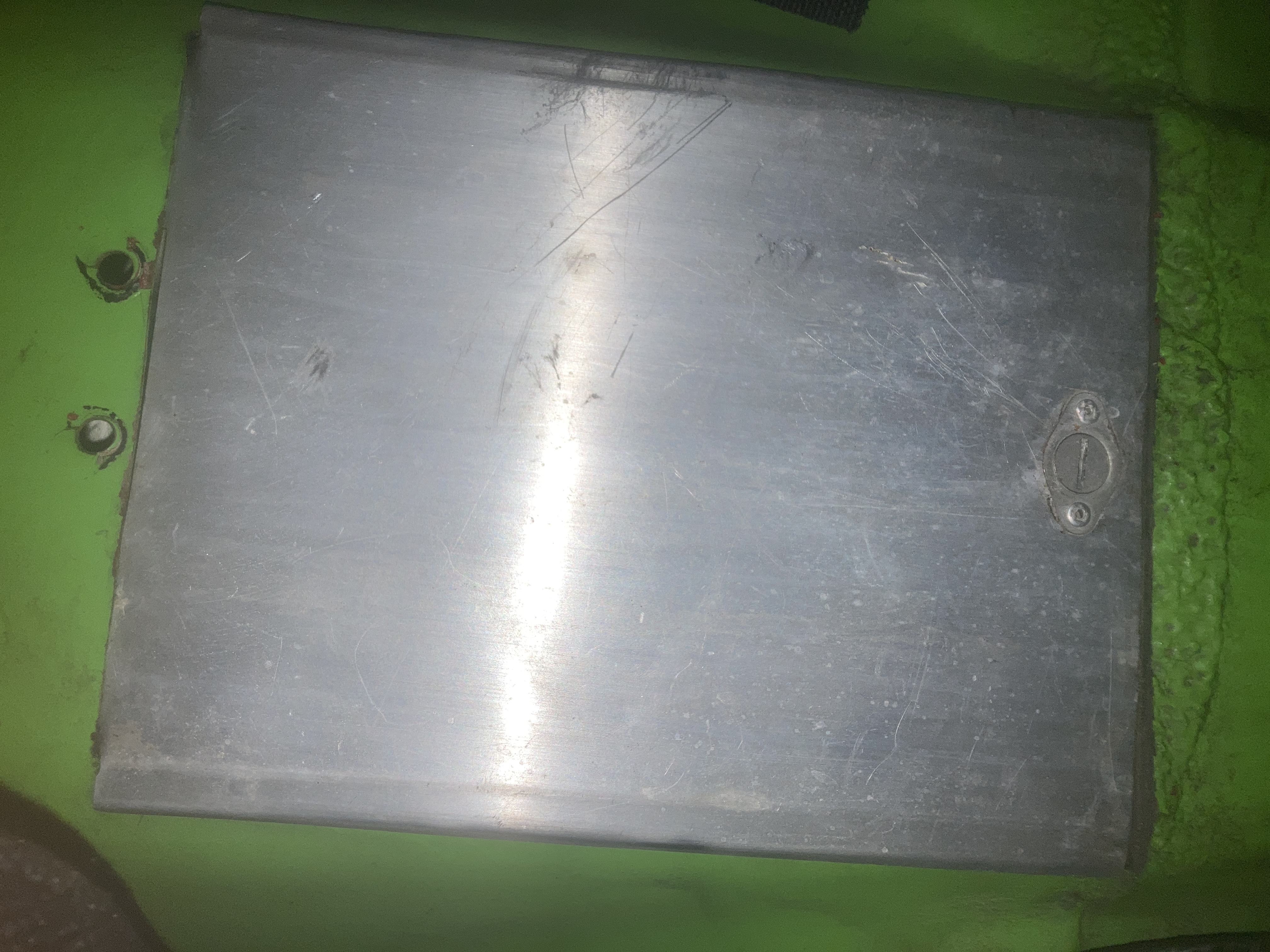

930cabman   I cut mine for the /6 conversion. It's a simpl...   Feb 29 2024, 10:57 AM

mlindner   I put one in my GT Tribute, helps a lot with servi...   Feb 29 2024, 11:40 AM
brant   Ours   Feb 29 2024, 12:10 PM
930cabman   Ours Looks very clean to me, I can't see ho...   Feb 29 2024, 04:21 PM
burton73   Ours Looks very clean to me, I can't see h...   Feb 29 2024, 07:13 PM
