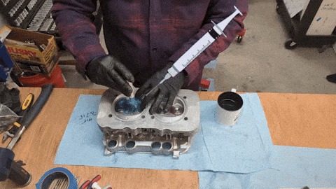

Did some measurements this weekend!
(IMG:http://www.914world.com/bbs2/uploads_offsite/media.giphy.com-23760-1709694116.1.gif)
My combustion chambers are 60ccs. Measured with fluid as well as called the manufacturer. Double confirmed.

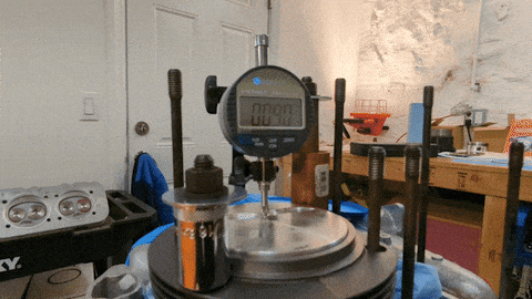

(IMG:http://www.914world.com/bbs2/uploads_offsite/media.giphy.com-23760-1709694117.2.gif)
Deck height is -0.090. Got that with a dial indicator.
@cgnj LMK if this is in your range if you recall...
@VaccaRabite great to know re: CR range (and thank you for the details, really)
So here's what I'm thinking, would love opinions...
• Base shim of 0.090
• Copper head shim of 0.08
That'll get an 8.6 CR
...a 0.060 copper shim would have gotten me to an 8.9CR. I would have run with that prior to reading this thread, but maybe not?

vjb206   If I'm 90 under and get a 90 shim I'll be ...   Mar 7 2024, 03:16 PM
Superhawk996   Can / should multiple cyl base shims be stacked ...   Mar 7 2024, 06:58 PM

VaccaRabite   I'd say that if you got 60cc measuring with yo...   Mar 8 2024, 12:25 PM
