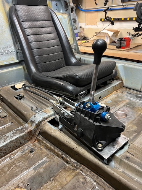

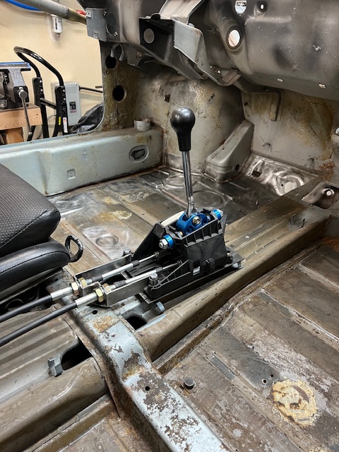

Shifter is mounted

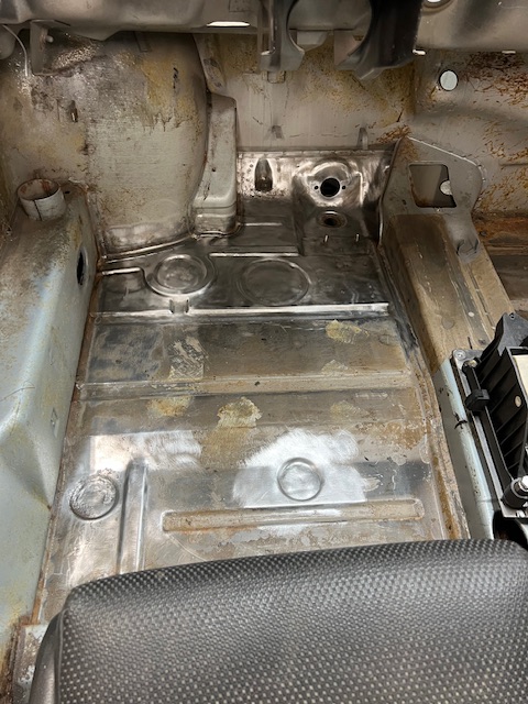

Cleaned up the driver’s footwell and welded all the access holes in the floor pan.

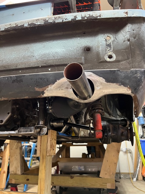

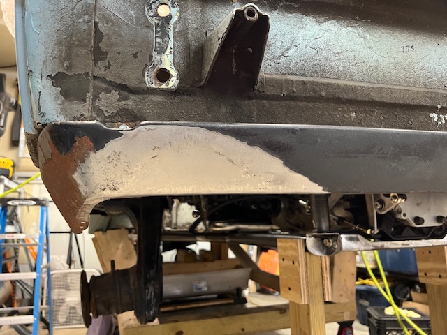

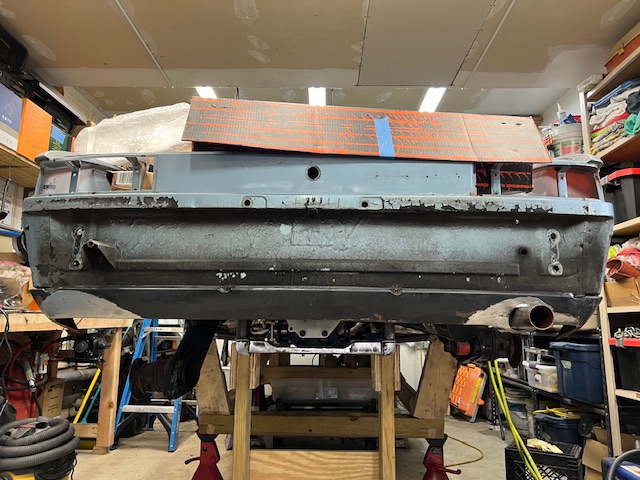

Finished the metal work on the rear valence (for now). I’m undecided if I’m going to keep this valence as is or make something else. I’m going to wait to see how I feel about it once the car is on wheels.

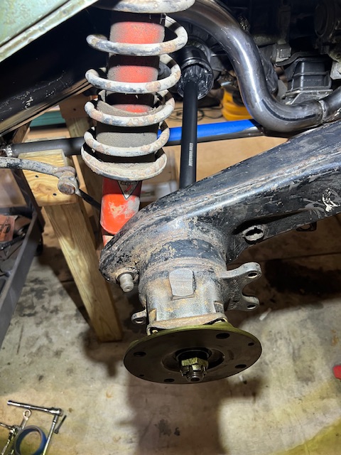

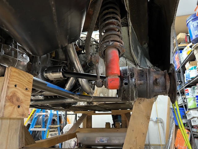

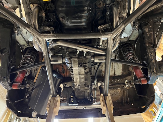

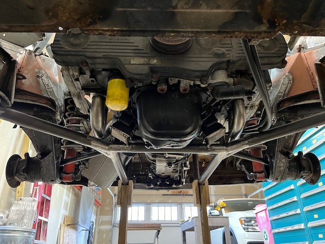

Did a rough install of the hybrid axles with the new exhaust and all the rear suspension parts to check for installation issues and adequate clearances. I also wanted all these parts in place for when I’m figuring out the shift cable routing. This was a good motivator for me.
