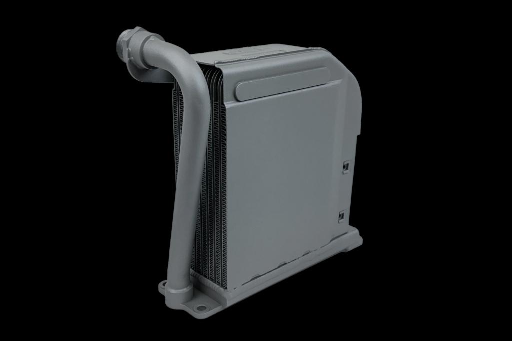

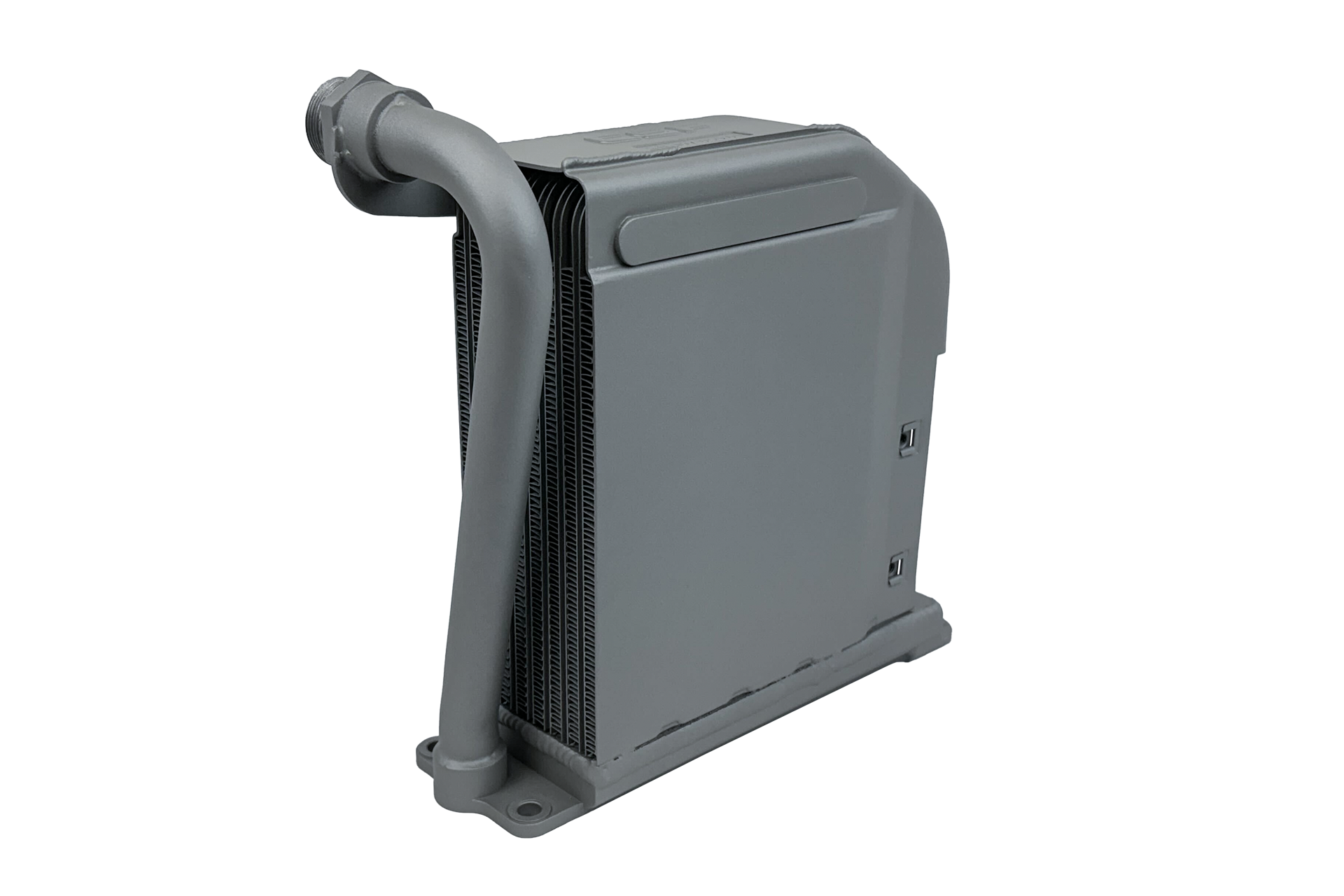

Regarding the previously mentioned cooler that I purchased out of Austria, I had it sent over to Pacific Oil Coolers and they red tagged it. Making it the second red tagged cooler in a row that I've sent them. This one had multiple core leaks unfortunately. These old coolers are aging out now at a high rate it seems.
I reached out to the seller on Pelican and he said it wasn't his problem. Imagine selling a $700 item that is completely useless and then saying "tough luck, not my problem"
I disagreed and luckily had buyer protection via paypal. Long story short, it took 6 months to get my money back and I was out about $150 in shipping costs and testing from Pacific on this bum cooler.
Seller was completely unreasonable, but I'm glad he had to (mostly) make me whole even though he drug it out as long as he could. Initially I offered to take a loss and offered for him to pay me a fraction of what I paid. He hardened his heart and said it wasn't his problem, so I went for the full purchase price with shipping and that's what he had to pay me back. Just a shame he wasted both of our times and soiled his reputation in the process. Steer clear of this seller is my recommendation.
So watch out for a used 914-6 cooler out of Austria. My experience is that this unethical seller will try to resell this bad cooler as I had to ship it back to Austria to do the paypal refund. It'll probably show up here in the classifieds or Pelican again. It looks brand new because Pacific cleaned up the outside when they tested it. He also hid damage to the outside in his pics and didn't mention any of that damage in his sales ad.
It's such a small community, I don't know why you wouldn't just say, "my bad, the cooler is trash, lemme refund you."
I sold many parts on Pelican and other Porsche sites. One time a guy reached out to me a year later with an issue. I offered a full refund on the spot. It wasn't even anything my fault, but my reputation is way more important than that.
In a case where a part is bad from the start and then verified faulty by a reputable third party company, why this individual would try to keep my money is beyond me.
Anyway, rant over, the silver lining is that CSF just introduced a really nice 914-6 cooler to the market so I'll be buying one of these babies! Pic courtesy CSF:

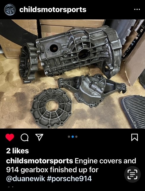

In other news, I reached out to Chris over at Childs Motorsports near Redding CA and inquired about using his chromate process to treat my recently torn down 901 side shift for the project.
I've been following him on IG for a while and like what I saw so i sent my 901 and some other parts off to him.
Chris was awesome to work with. Good communication and reasonable prices. His process is a chemical conversion coating. The parts get dipped into a bath that reacts with the magnesium to convert the surface layer. The bonus is a nice black sheen like early Porsche race boxes. I guess it's similar to the Dow 7 process and provides a corrosion resistant layer. He then sprays some wd40 to further help with corrosion resistance.

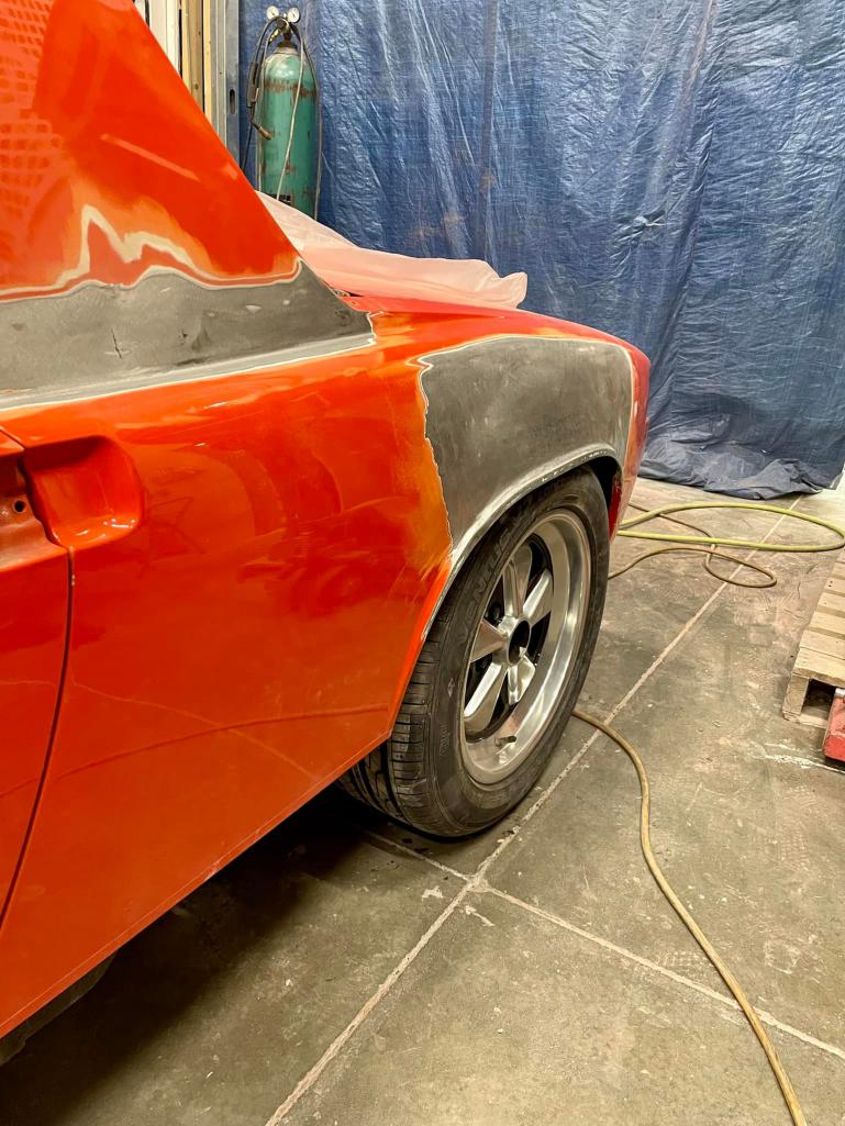

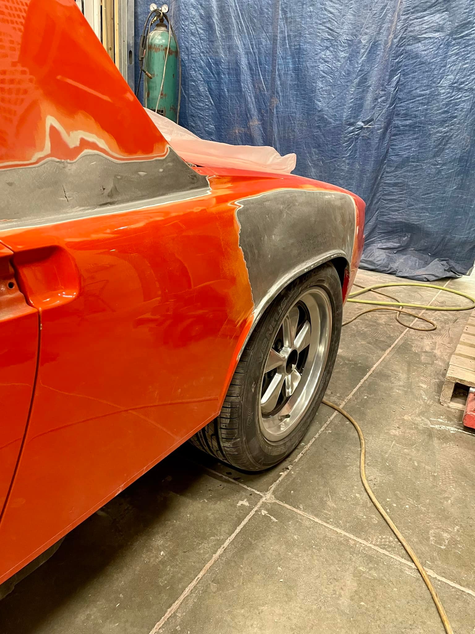

Graydingo   Here's the bumper fitment, It's actually t...   Aug 6 2026, 03:43 PM
friethmiller   So I'm wondering how close these fenders shou...   Aug 6 2026, 03:57 PM
Graydingo   Good call Fred. I think the drv side migrated outw...   Aug 6 2026, 04:34 PM

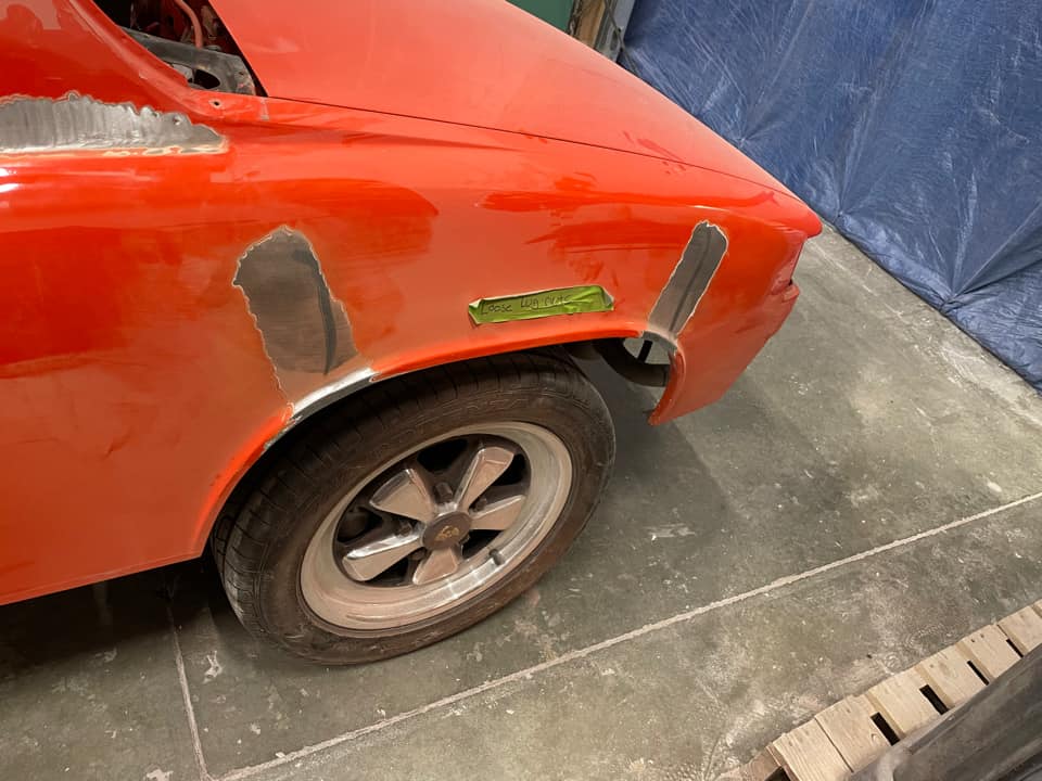

Graydingo   Major front end repair continues. -Removed right...   Sep 9 2026, 06:19 AM

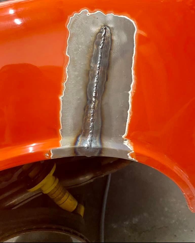

MikeK   Seeing how you're currently using MIG and plan...   Oct 18 2026, 11:10 AM
Graydingo   Seeing how you're currently using MIG and pla...   Oct 18 2026, 01:54 PM
MikeK   Seeing how you're currently using MIG and pl...   Oct 19 2026, 10:36 AM
