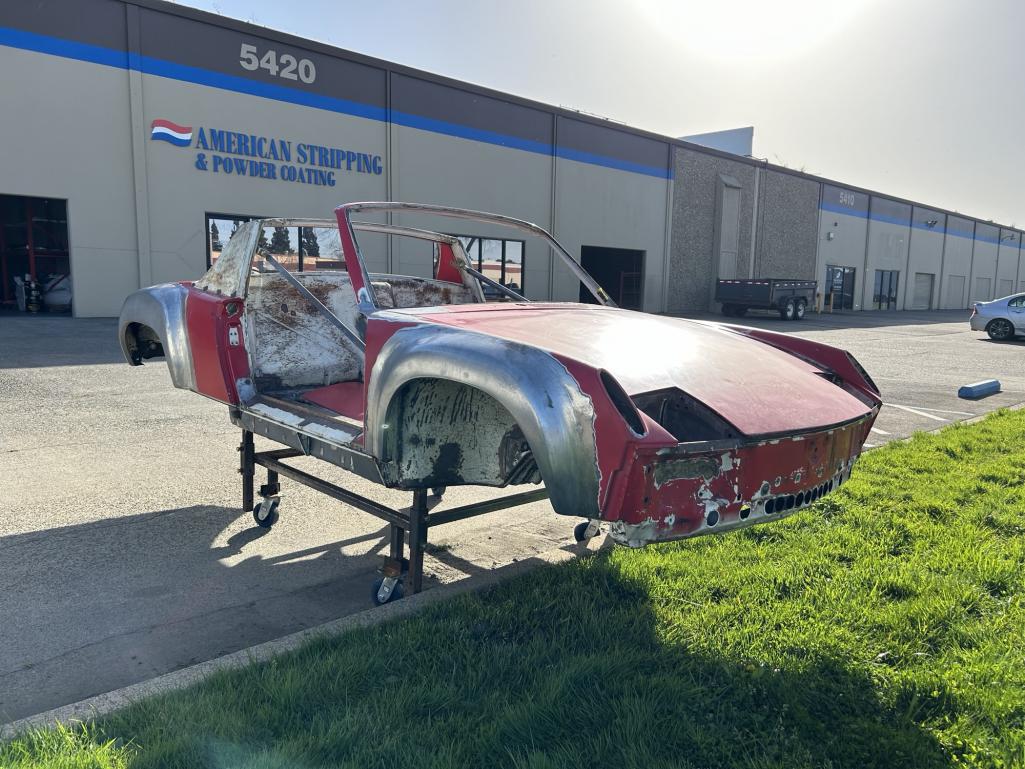

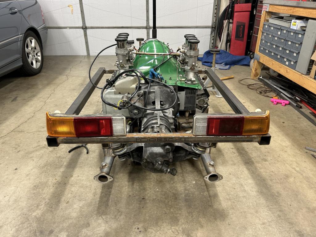

Finally got the shell dropped off at the media blasting place! (IMG:style_emoticons/default/aktion035.gif) Now freeing up garage space to finish the engine test stand, and hopefully get this thing fired up and ready to go by the time it gets back. (~2 months).
There will be a few patches that will be needed but I don't expect anything big. Mostly in the driver side door there was a rust hole on the bottom front corner that will need repair. Lucky its in a spot that's inconspicuous.
Now to research what undercoating I want to use... I'm in between the three following products:
  • 3M Dynatron Dyna-pro 544
  • Wurth SKS
  • LizardSkin
Felt cute, had to add the tail lights. This makes me want to build a single seat open-wheel racer from tube steel (IMG:style_emoticons/default/idea.gif)
