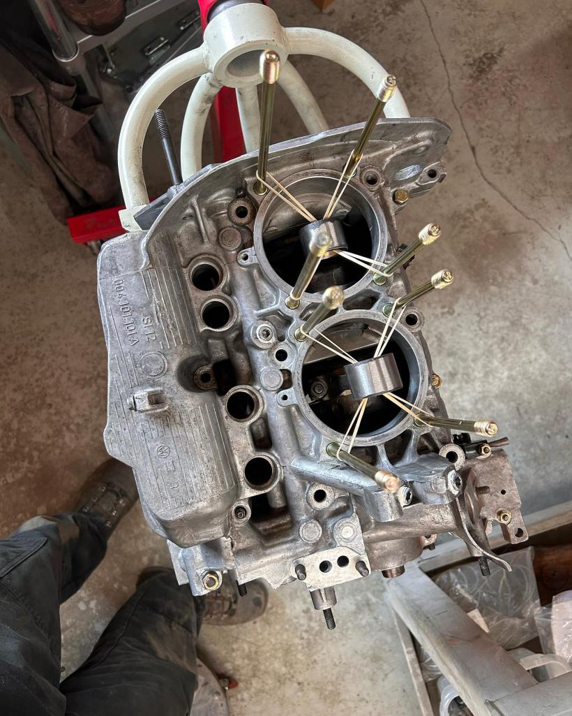

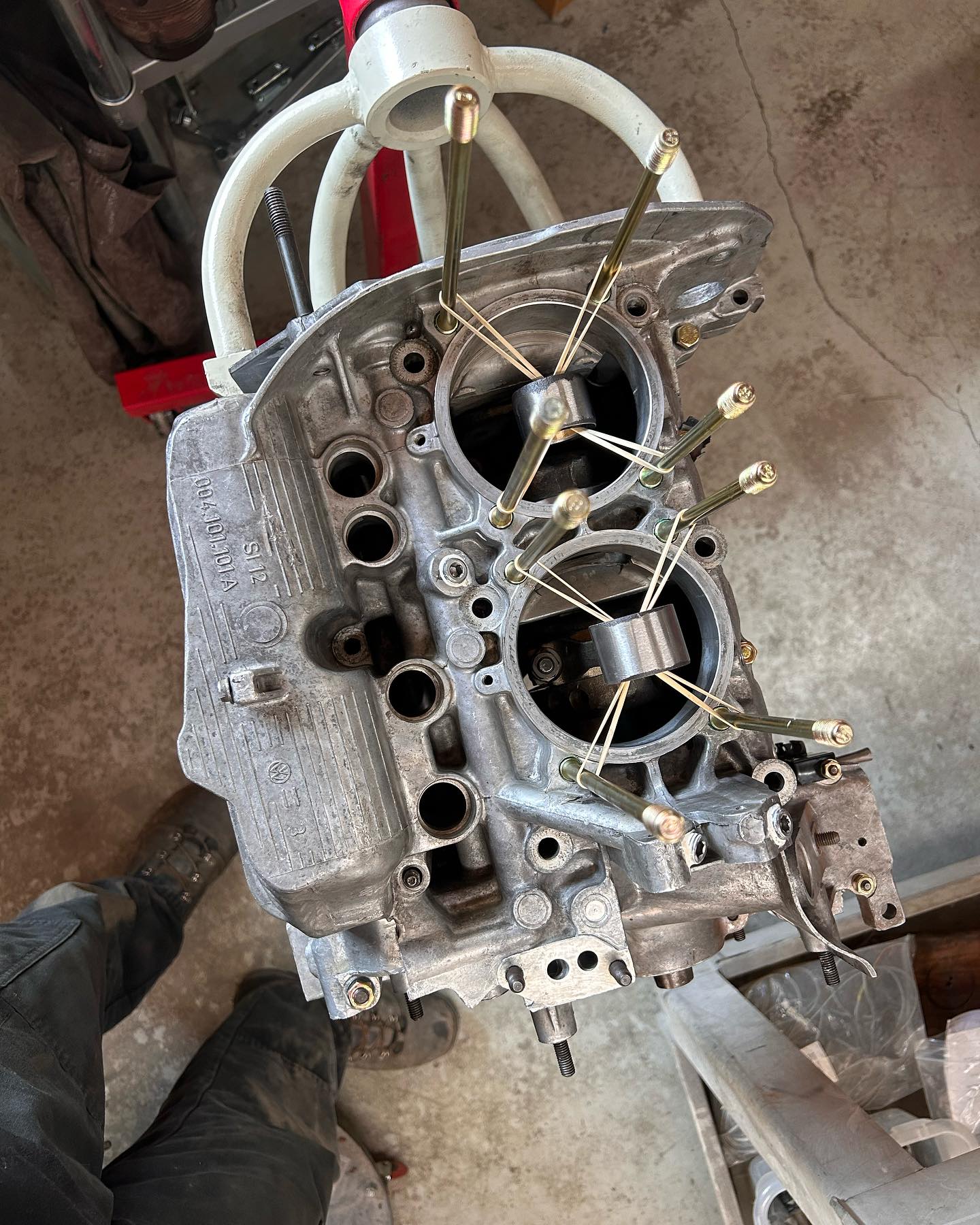

Hey folks! I have the bottom-end of my 2270 assembled and spinning freely. Thanks to all who helped me get to this point!
(IMG:http://www.914world.com/bbs2/uploads_offsite/media.giphy.com-23760-1708984357.1.gif) To quickly recap: I bought the 2257 kit from AA Pistons (78mm stroke, 5.158" rods, etc.). And when I threw a P&C on for a test-fit last weekend, I immediately noticed the piston sitting proud of the deck height at TDC (negative deck) by about 2mm. (IMG:http://www.914world.com/bbs2/uploads_offsite/media.giphy.com-23760-1708984358.2.gif) Before I overreact, or buy the wrong stuff, I thought I'd ping the community...
Once I figure out whether or not this is normal (I.E. verifying that I don't have to backtrack), I'll get into the CR questions (just waiting on clear plastic from Amazon so that I can measure my CC volume this weekend) (IMG:style_emoticons/default/biggrin.gif) Thanks! |

Rubber bands were mentioned found this picture to add
