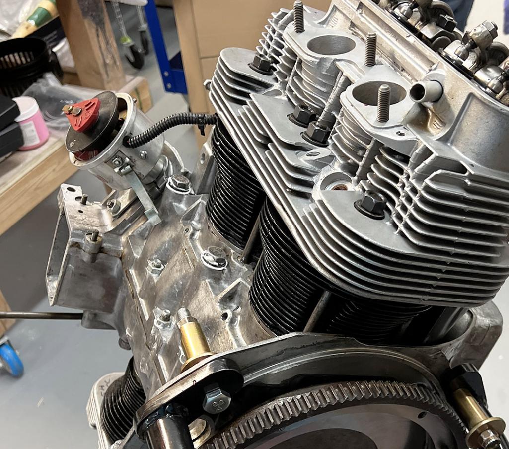

Here is a picture of Marks 2270 RAT built 2005 Engen built by Jake in 2005
Note the shims and there was a thin coper head gasket.
This bad boy spun a bearing and had a knock. George at EMS helped us with all machining parts and advice. We even took the Eng over to EMS to test fire it up on a pallet. Then EMS sent it over to PMB for the install in my old Blue 74

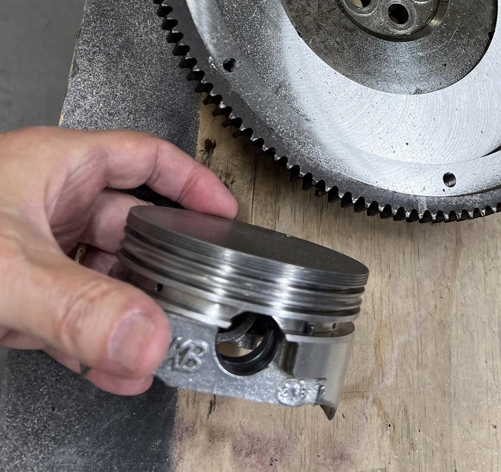

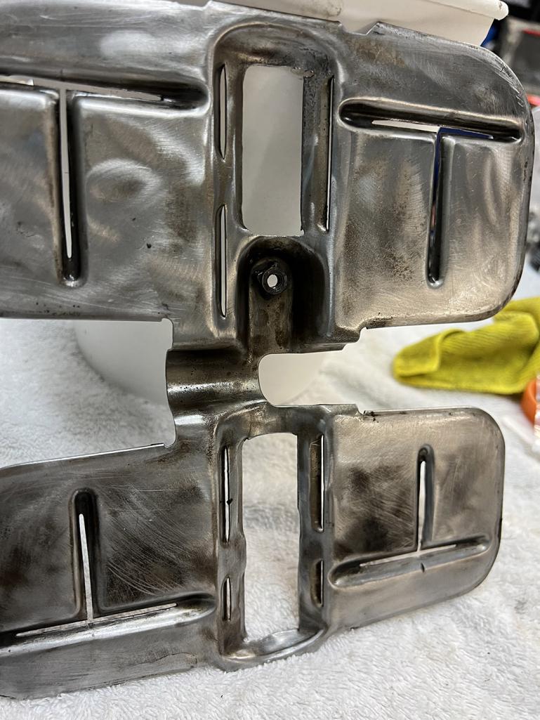

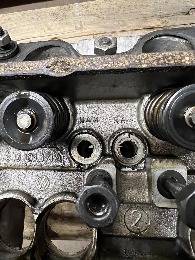

The pistons are KB and they are flat tops. I believe the pistons are used for Harley Davidsons. Note the positions of the wrist pins. Cylinder light hone and new rings. Rebuilt the HAM RAT heads all the parts came from EMS Note the oil tray with the RAT Jake touch.

burton73   Mark to show shim on the RAT rebuild 2270 Bob B   Mar 19 2024, 11:58 AM

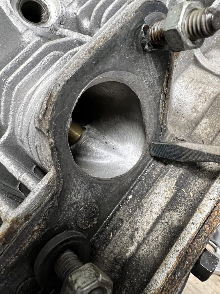

burton73   The picture of intake port is from the moment of t...   Mar 19 2024, 03:15 PM
VaccaRabite   The Windage tray modification was a RAT deal in...   Mar 20 2024, 05:22 AM
