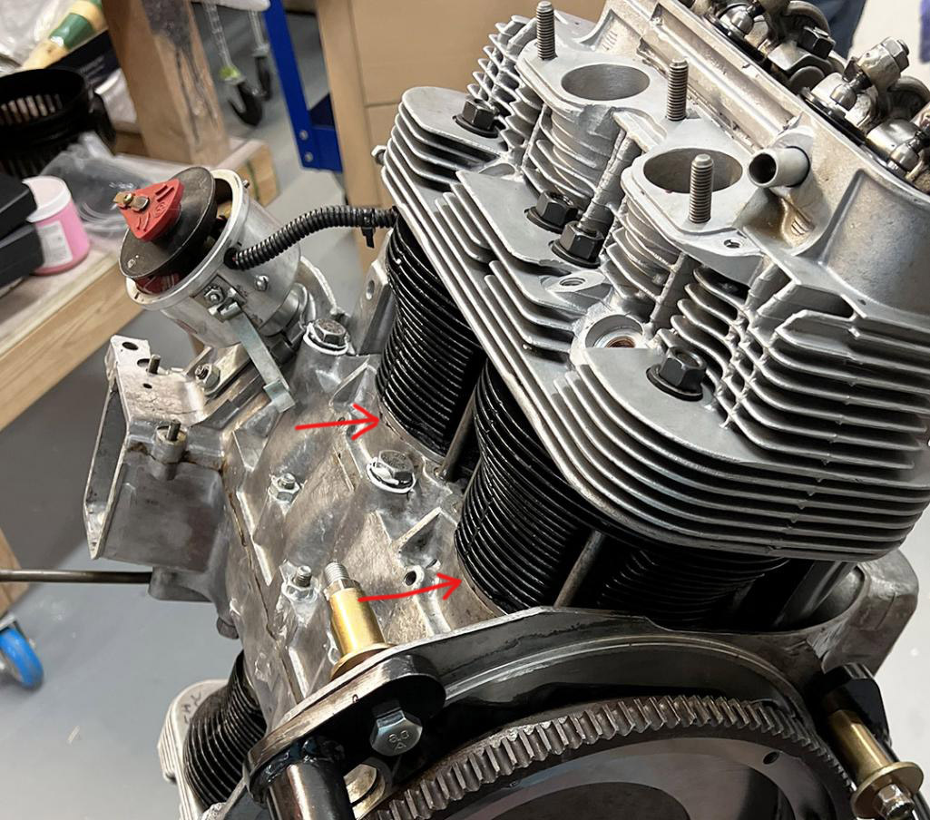

burton73   Here is a picture of Marks 2270 RAT built 2005 Eng...   Mar 19 2024, 10:37 AM

burton73   Mark to show shim on the RAT rebuild 2270 Bob B   Mar 19 2024, 11:58 AM
technicalninja   OOOHHHH! Pretty pictures! Thanks Bob! ...   Mar 19 2024, 01:04 PM
Jack Standz   Yes, noticed that too. We run phenolic spacers w...   Mar 19 2024, 01:25 PM
cgnj   I cut my own gaskets. CSP linkage threaded rods to...   Mar 19 2024, 02:38 PM
burton73   The picture of intake port is from the moment of t...   Mar 19 2024, 03:15 PM
VaccaRabite   The Windage tray modification was a RAT deal in...   Mar 20 2024, 05:22 AM
technicalninja   When I'm "finished" with port matchi...   Mar 19 2024, 05:21 PM
