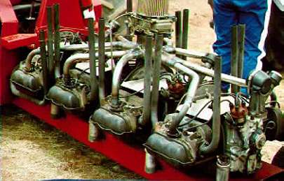

Brando   or connect them at the cranks... if you're go...   Jan 29 2005, 05:12 AM
SpecialK   Screw pistons...........someone stick a Huey Turbi...   Jan 29 2005, 05:18 AM
