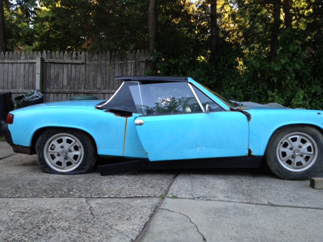

If you are not willing to spend the money for a full restoration, you will not be able to drive it for another 30 years. The rust you CAN see is only 20% of what is there. BTW, you should not have even been driving that car with that much rust. 914's have been known to break in half.
I have junked better cars than that due to rust. I realize this car is special to you but in my opinion, you need to let it go. It is far cheaper to swap parts over to a new tub. And if you have a build party, you can get many of us to help. You buy the beer and pizza...
Craig's list has plenty of rollers to be had for $1K-$3K.
Here are some examples of too much rust in the longs. If you get in another accident, this could (will) happen...
