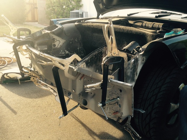

Hello,
I have been trying to find someone who knows 914's in the Los Angeles area.
I had an accident a few weeks ago, damaged the front (see images).
I have been collection the parts for the repair. I have been asking everyone around here for a shop that knows 914's but not much luck, mostly 911 shops.
Along with the front end damage, I have a few rust issues that need to be addressed.
I found shops that are willing to do the front end repair but not the rust damage.
One of the shops would not touch the car unless I did a full rotisserie restoration. I don't have the funds for that extensive a project.
The rust is concentrated in the outer longs area (see images)
I am pretty competent with the 914 mechanicals. I have owned this car for 31 years and have been wrenching it myself, (only other person to do any work on the car in 30+ years is the guy I trust to do my wheel alinements).
I am trying to find someone close to the Los Angeles area that has done this before and knows 914's hopefully as well as I do.
Thanks in advance for any info you may have.
Mike

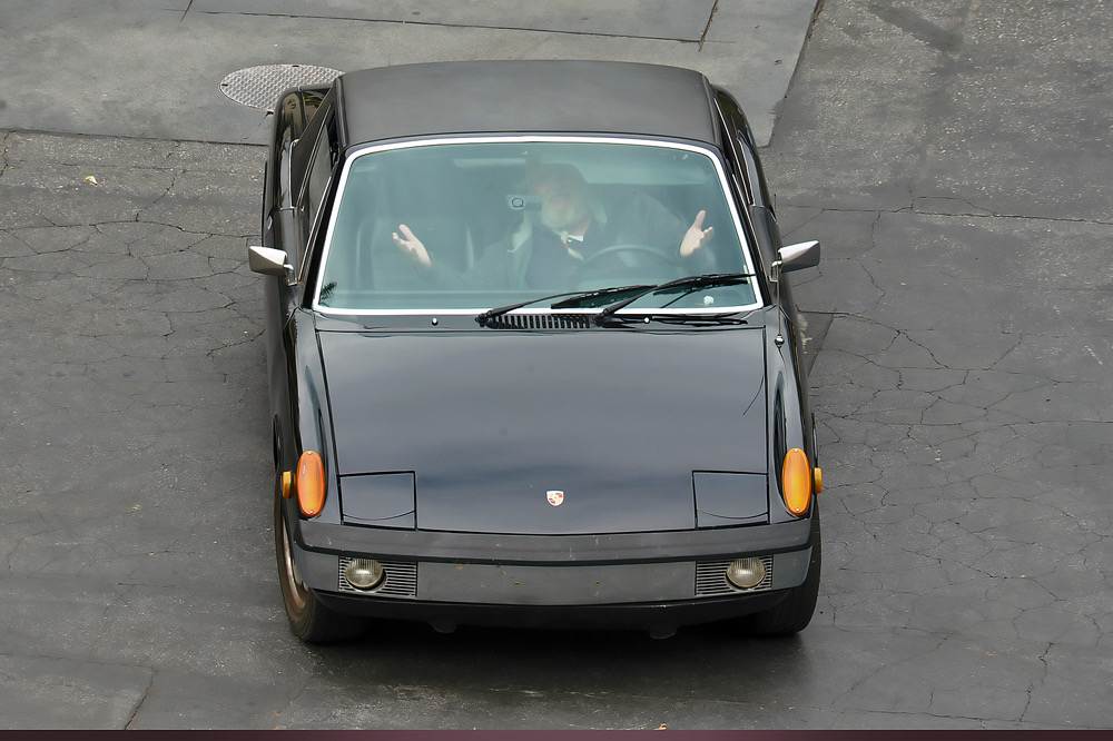

mgphoto   So this was 11 years ago, would you save this car ...   Apr 8 2024, 10:10 AM
Superhawk996   Reminded of the late, great, Brent Brock. No, I ...   Apr 8 2024, 10:23 AM
rjames   No. It's still a parts car.   Apr 8 2024, 12:00 PM
mgphoto   No. It's still a parts car. Jokes on you ...   Apr 8 2024, 01:40 PM
nathanxnathan   Jokes on you Bet on passion every time. Front...   Apr 8 2024, 02:10 PM
rjames   Jokes on you Bet on passion every time. Fron...   Apr 8 2024, 03:03 PM
Superhawk996   :trophy: congratulations - that’s gotta’ feel ...   Apr 8 2024, 02:09 PM
Superhawk996   I remember the longs being repaired and we compare...   Apr 8 2024, 07:12 PM
