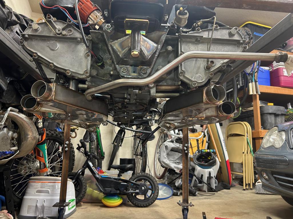

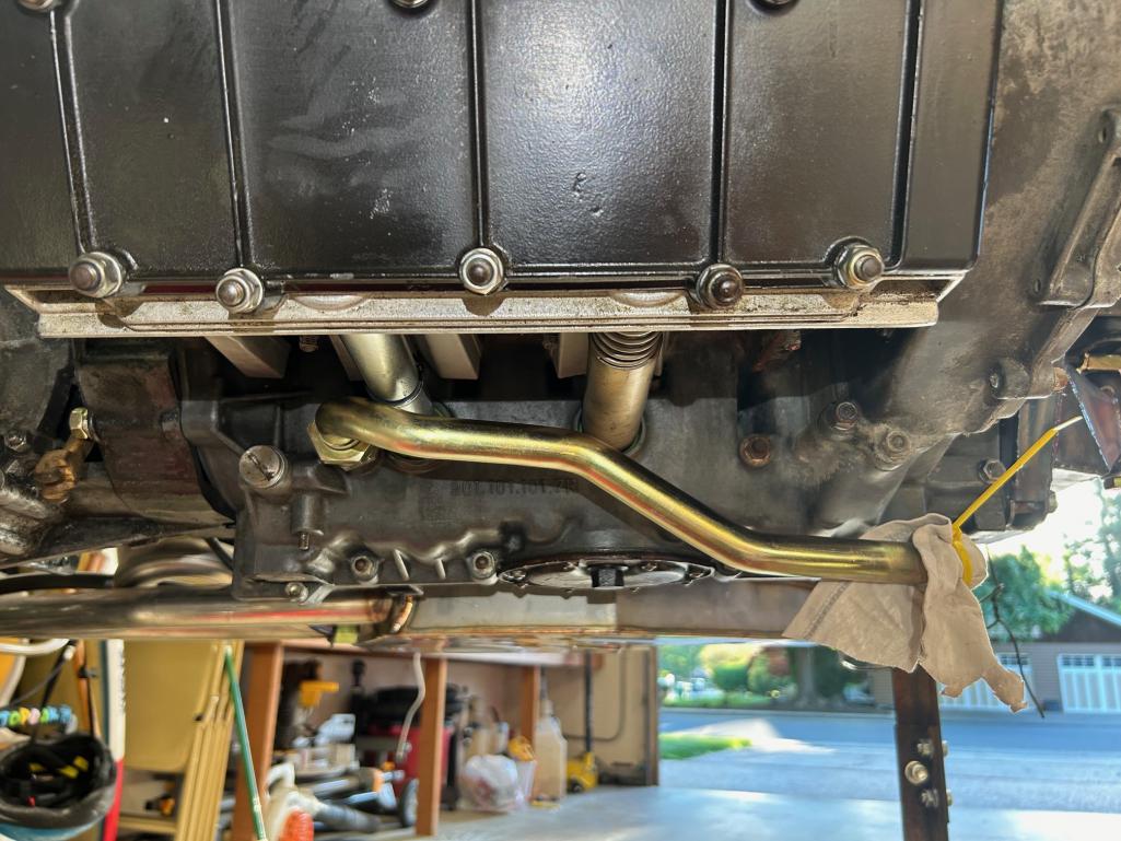

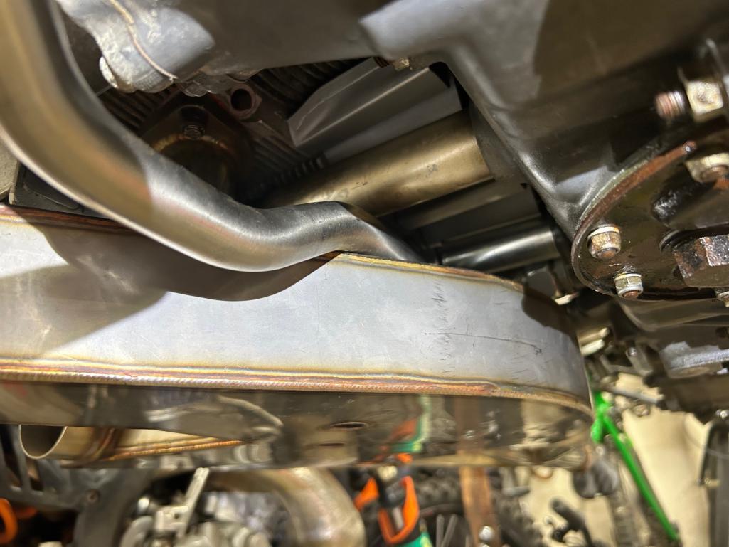

While the car is off to media blast/epoxy primer, I'm doing some of the plumbing. I noticed the pre-bent oil pipe from Patrick Motorsports hangs too low to be used with Ben's heat exchangers. Hopefully they allow returns on this thing, since it cost quite a bit.
I did acquire a pre-bent oil pipe from another member here, which I believe this is Ben's work, but upon bolting it up I noticed it contacts the heat exchangers. I can't move this up any further, since its already in contact with the oil return tube between cylinder 2-3.
Anyone running this setup of the pre-bent stainless hard line with Ben's heat exchangers?
