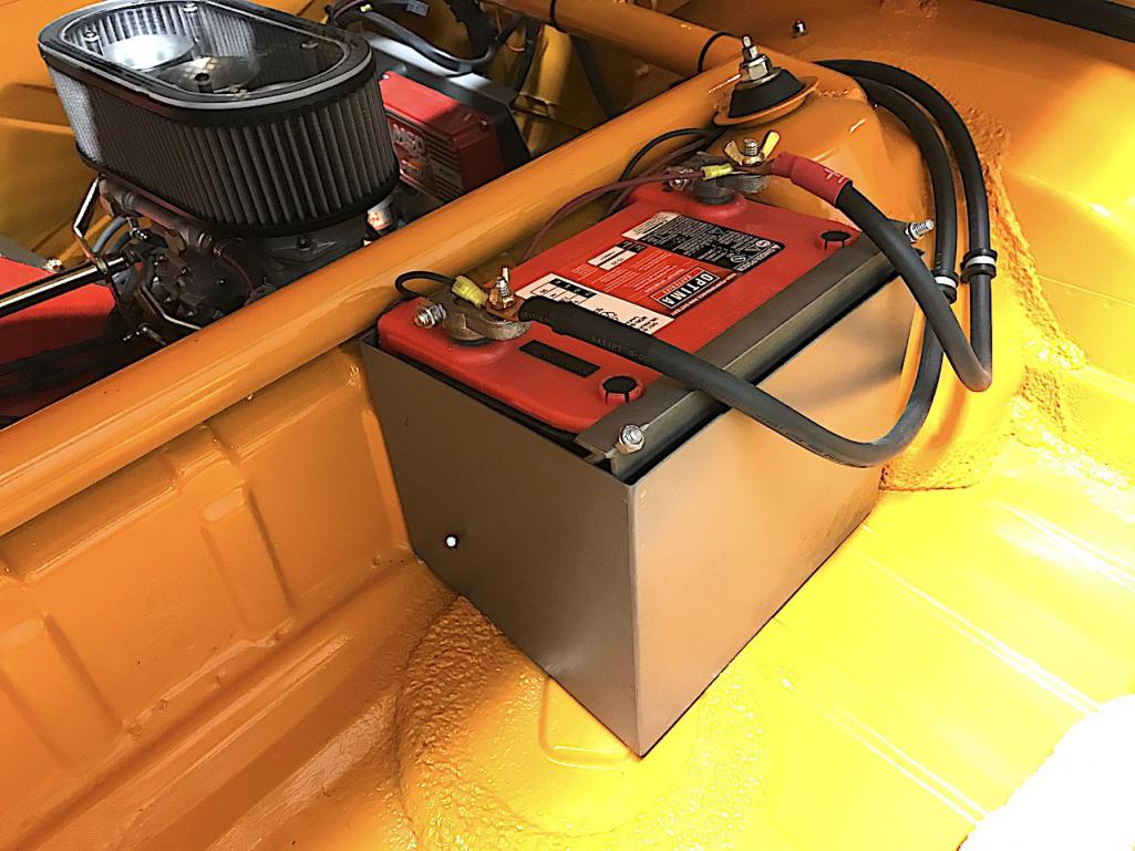

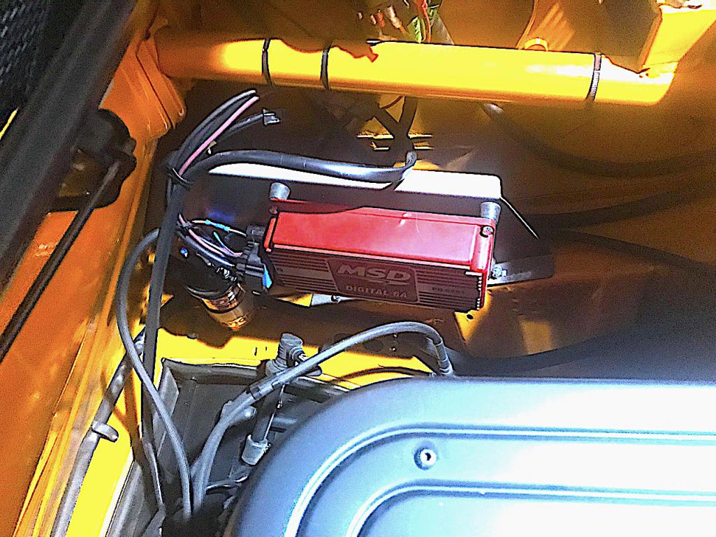

I moved the battery to the trunk. Then fabricated a panel to hold both the MSD box and coil. Did have to get a longer coil wire. It does open up the engine compartment a lot. MarkAttached Image Attached Image
