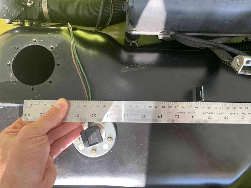

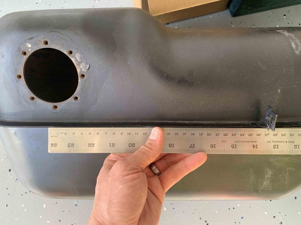

However, the measurements do not match re distance from the center of the filler hole to the drivers side tab for the expansion tank (which is the reason I cannot get the expansion tank of after bolting down the fuel filler piece). The driver side tab is 10 mm further toward the driver side as you can see in the pics below (old tank is approx. 27.5 mm and the new tank is approx. 26.5 mm).
OLD TANK:
NEW TANK:

DC_neun_vierzehn   The measurement between the two tabs appears to be...   May 29 2024, 07:30 AM
DC_neun_vierzehn   However, the measurements do not match re distance...   May 29 2024, 07:54 AM

BillC   I think you found the problem -- the fuel filler h...   May 29 2024, 08:11 AM
