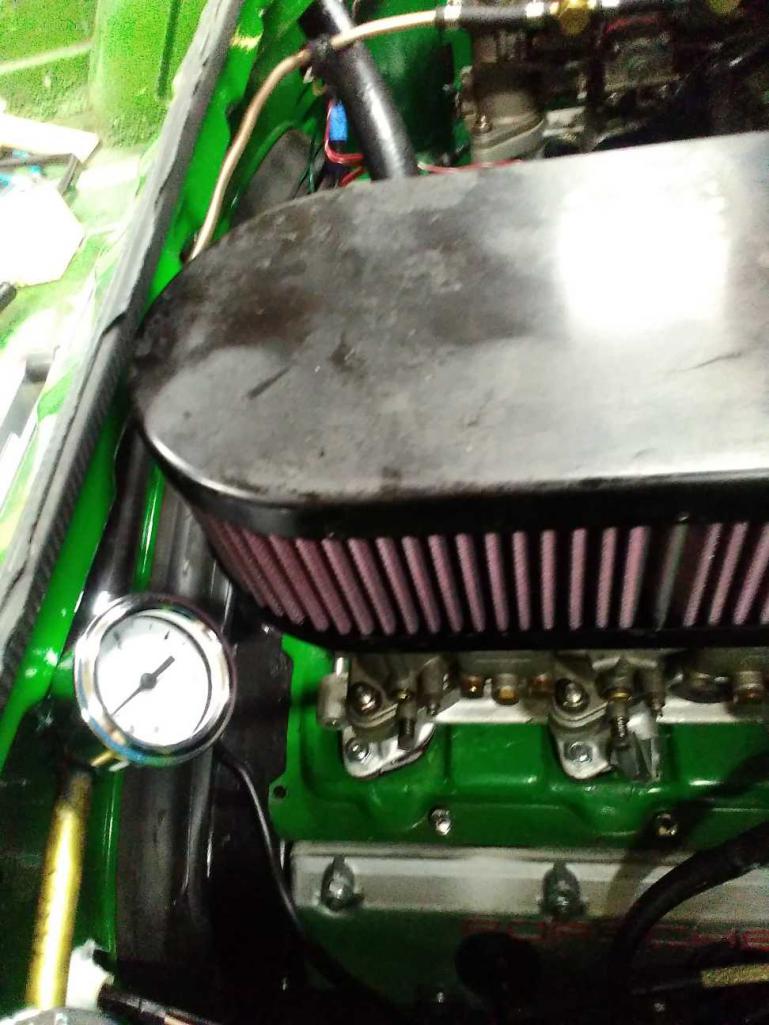

Clearance is very tight here, a factory style will never fit here

930cabman   But there's more Clearance is very tight h...   Jun 6 2024, 04:55 AM
gereed75   But there's more Clearance is very tight ...   Jun 6 2024, 07:26 AM
930cabman   But there's more Clearance is very tight ...   Jun 6 2024, 10:24 AM
