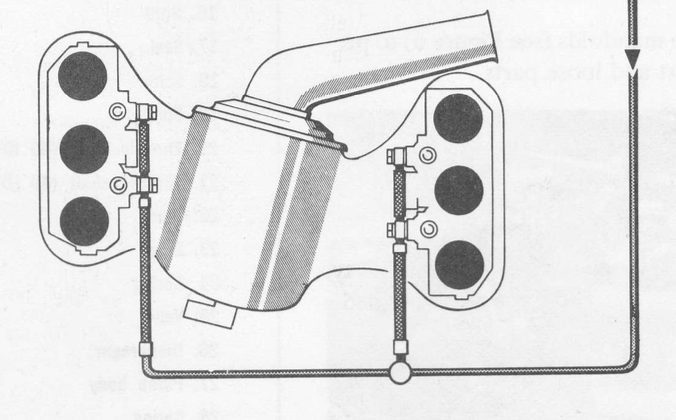

I'm not sure the source of this, but I have a PDF file about 914-6 Fuel System. A drawing in there seems to support the 6 hole configuration.
