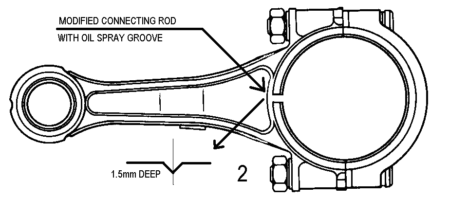

BTW #5 should be performed on ALL T4 builds (using stock rods) (IMG:style_emoticons/default/aktion035.gif) ... IMO

914werke   BTW #5 should be performed on ALL T4 builds (usin...   Jun 18 2024, 12:11 PM
930cabman   BTW #5 should be performed on ALL T4 builds (usi...   Jun 18 2024, 12:17 PM
914werke   correct. Poor mans oil squirter!   Jun 18 2024, 12:18 PM
rick 918-S   Question: The update states improvements were mad...   Jul 2 2024, 06:54 AM
Superhawk996   Question: The update states improvements were ma...   Jul 2 2024, 07:22 AM
rick 918-S   Question: The update states improvements were m...   Jul 2 2024, 09:05 PM
Superhawk996   Type IV rods can be notched, Cylinders can be h...   Jul 2 2024, 09:57 PM
