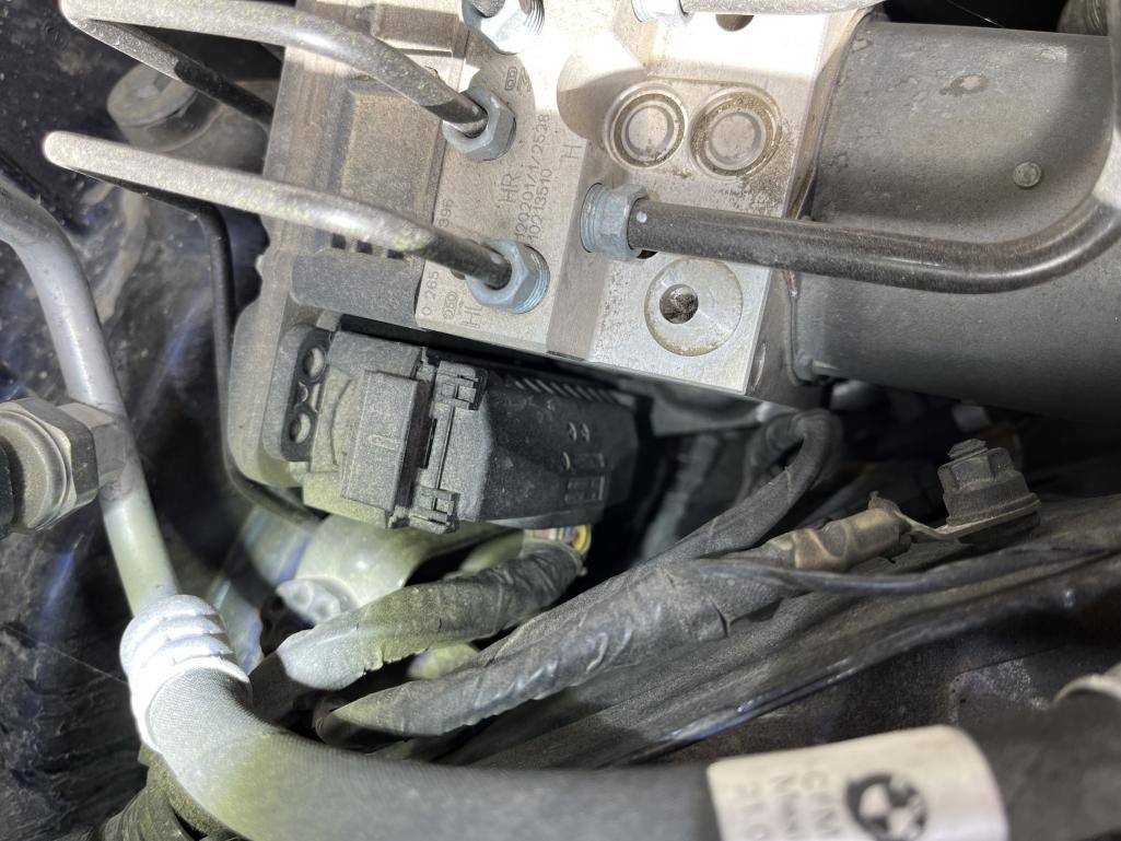

2012 BMW ABS module - safety component
Gets a hard back shell due to tight bend radius on a large bundle of wires that could otherwise not make that bend without stressing the pins.
