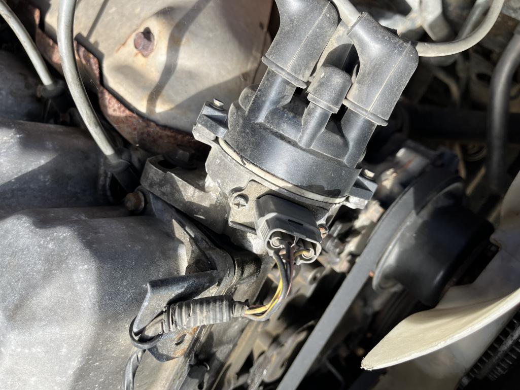

1992 Mazda B2600 - 178k miles
Distributor - no work, no go. You can be sure the Japanese would have used a more robust connector if it was necessary. Attached Image

Superhawk996   With all due respect, opinion doesn’t matter. ...   Jun 19 2024, 11:01 AM
Superhawk996   1997 Toyota Camry The Japanese have an incredibl...   Jun 19 2024, 11:06 AM
Superhawk996   Oxygen sensor - wires potted in sensor but no boo...   Jun 19 2024, 11:11 AM
Superhawk996   2012 BMW - 138k miles Note the varying use - stan...   Jun 19 2024, 11:20 AM
Superhawk996   2012 BMW ABS module - safety component Gets a ha...   Jun 19 2024, 11:24 AM
Superhawk996   1992 Mazda B2600 - 178k miles Distributor - no ...   Jun 19 2024, 11:26 AM
Superhawk996   2009 Jeep Wranger. 90k miles. Again - plastic ca...   Jun 19 2024, 11:31 AM
Superhawk996   These are just 4 random OEMs that happen to be sit...   Jun 19 2024, 11:39 AM
Superhawk996   @jeffbowlsby No offense is meant by this post. ...   Jun 19 2024, 11:50 AM
