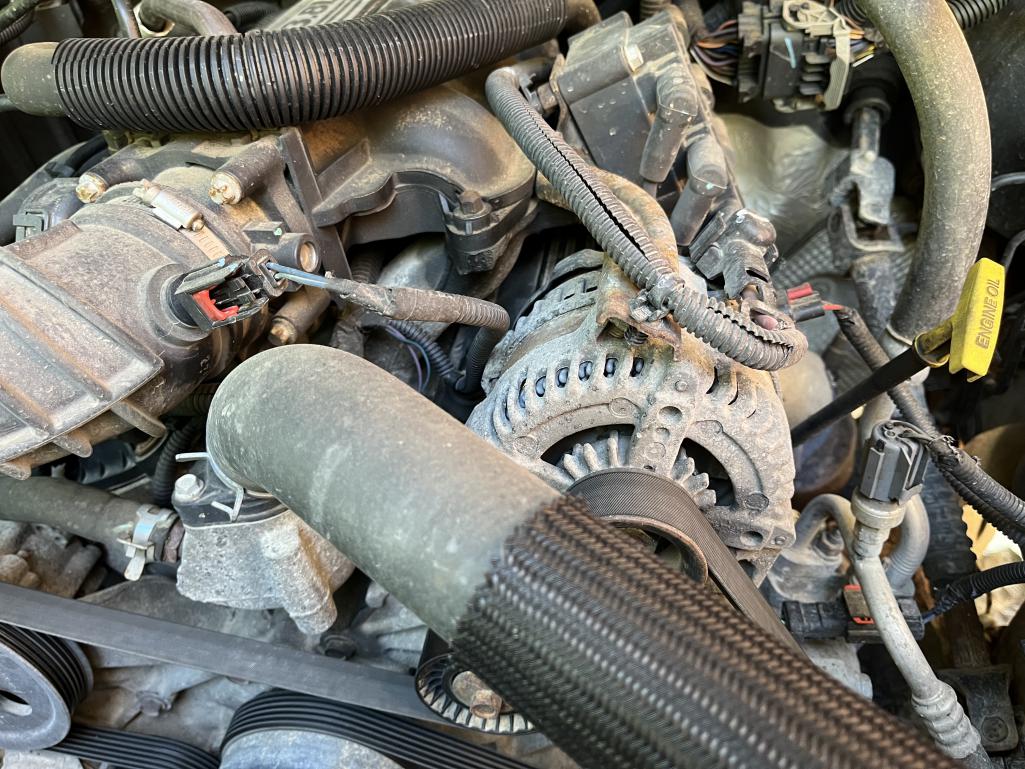

2009 Jeep Wranger. 90k miles.
Again - plastic cap used over alternator B+ for short protection
Lots of connectors including large multipin that use standard weather pack, Deutche type connectors.
These are all under hood but the same connectors are also used in the underbody in wet locations subject to water fording requirements
