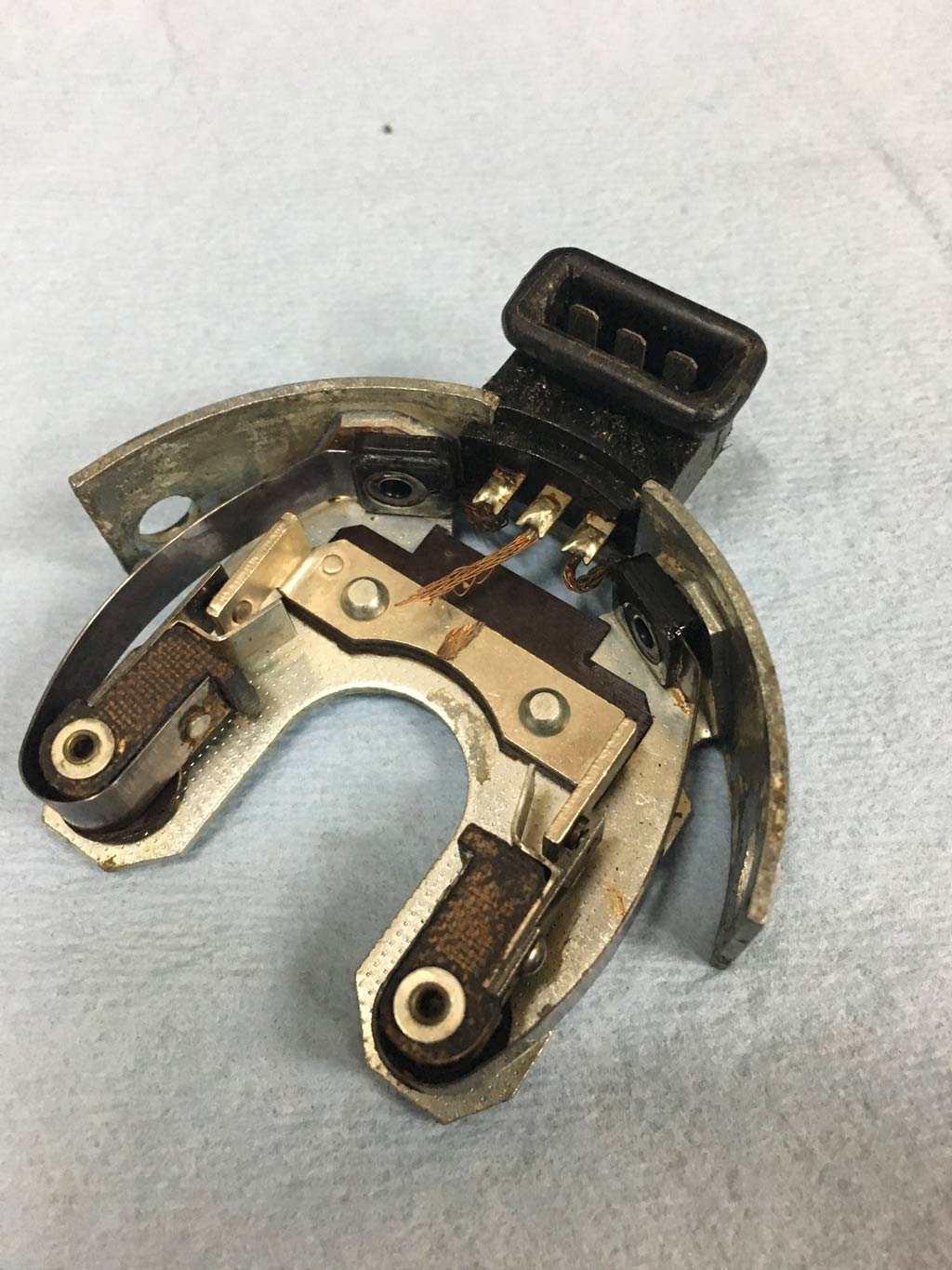

Seems to be LOTS of replies to this thread, but no one seems to see the forest for the trees.
That connector is on the old D-Jet trigger points. It would seem that salvaging the connector off a junk set of trigger points would be a simple solution.
Or am I missing something here?????

Seems reasonable . . . But
Pulling this connector off a set of triggger points, soldering 123 dizzy leads to it, and then having non-locking spade connections and rubber boot on this isn’t going to be anywhere near as robust as converting to a Deutche connector.

I don't have a 123 distributor, but I could see taking it apart and adding this to the side of it instead of just having wires come out of it.

QUOTE(ClayPerrine @ Jun 21 2024, 09:10 AM) *
Honestly that isn’t a terrible idea . . . It’s sort of a shame how crude the 123 is with respect to how the wires exit the dizzy body.
Given 123’s aren’t cheap it would be wonderful to see them with a OEM style connection for those that don’t want to cut up their OEM wiring to use the 123. This would be true for other high end OEMs they support (jaguar, Aston, etc). I do have sympathy for them with respect to how much complexity this would add for them.
Not having one myself to look at, I’ve got to imagine it would be some careful mill work to even have the potential of being a modification that would work. And that’s assuming there is space inside and away from the electronics.
