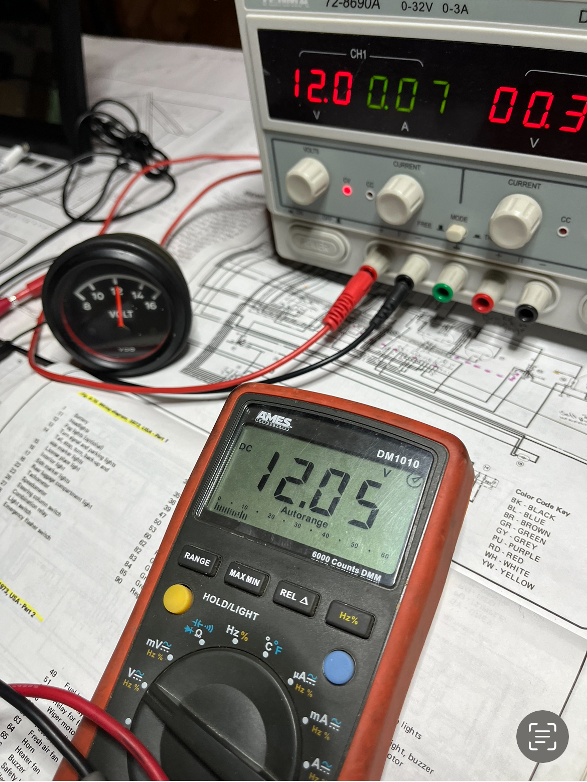

Starting a new thread in response to @emeryGT 350 comment in another thread as follow up
Here’s the background:

Gauge #2 12v nominal

windforfun   What's the problem? How exactly do you expect...   Jun 24 2024, 08:11 PM
Superhawk996   What's the problem? How exactly do you expec...   Jun 24 2024, 08:20 PM
windforfun   Copy that. The power supply reads out to one plac...   Jun 24 2024, 08:40 PM
Superhawk996   Copy that. The power supply reads out to one pla...   Jun 24 2024, 10:18 PM
windforfun   Copy that. The power supply reads out to one pl...   Jun 25 2024, 09:03 AM
Superhawk996   Recognize anything? @windforfun Nice test ...   Jun 25 2024, 09:33 AM

Superhawk996   I should double check my ground shouldn't i...   Jun 25 2024, 06:32 AM
GregAmy   Unless you want to rewire it directly to the batte...   Jun 25 2024, 07:11 AM
emerygt350   Unless you want to rewire it directly to the batt...   Jun 25 2024, 08:44 AM
technicalninja   Thanks, Superhawk! The dash meters are FAR mo...   Jun 25 2024, 08:08 AM
emerygt350   Just checked the grounds engine to body engine to ...   Jun 25 2024, 09:25 AM
Superhawk996   Just checked the grounds engine to body engine to...   Jun 25 2024, 09:29 AM
Superhawk996   gauge #1 Delay and damping behavior related to in...   Jun 25 2024, 09:53 AM

Superhawk996   Gauge #2 Slightly different damping behavior. P...   Jun 25 2024, 05:18 PM
emerygt350   It is interesting how in both cases they behaved b...   Jun 25 2024, 07:19 PM
Superhawk996   It is interesting how in both cases they behaved ...   Jun 25 2024, 07:54 PM
emerygt350   I finally dug into the console. I had compared th...   Jun 26 2024, 05:02 AM
Superhawk996   :trophy: Now those delays and variable voltage d...   Jun 26 2024, 06:08 AM
