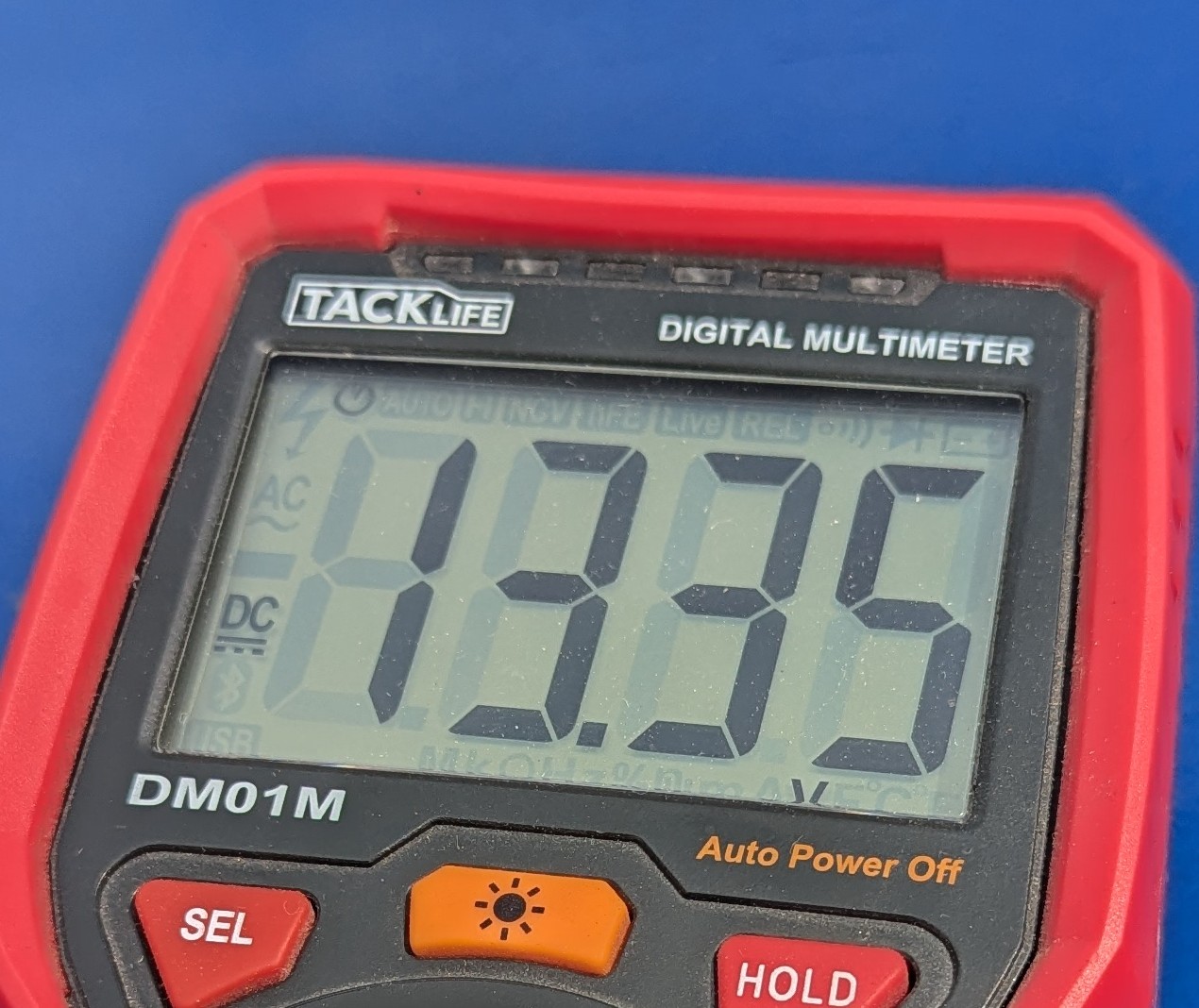

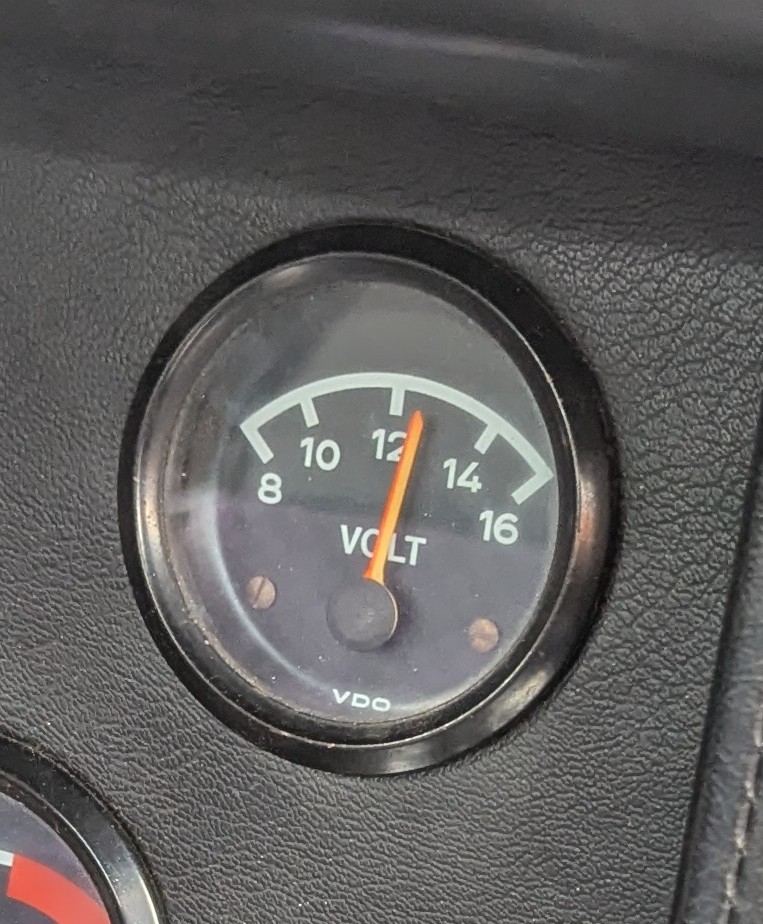

Starting a new thread in response to @emeryGT 350 comment in another thread as follow up

Superhawk996   Gauge #1   Jun 24 2024, 07:36 PM
emerygt350   Very interesting! Could you do some readings ...   Jun 24 2024, 07:39 PM
Superhawk996   Yup will do Here’s 14v.   Jun 24 2024, 07:42 PM
Superhawk996   RE: Voltmeter Behavior   Jun 24 2024, 07:46 PM
Superhawk996   Gauge #1 at 13.7v Gauge #2 at full scale - wa...   Jun 24 2024, 07:54 PM
Superhawk996   Gauge #2 12v nominal   Jun 24 2024, 08:09 PM

Superhawk996   Recognize anything? @windforfun Nice test ...   Jun 25 2024, 09:33 AM
emerygt350   I was interested in the behavior of the voltage me...   Jun 25 2024, 04:46 AM
mb911   Good data. Unfortunately mine is right on.   Jun 25 2024, 05:17 AM
914Sixer   60's-70's are what I call ball park gauges...   Jun 25 2024, 05:53 AM
emerygt350   I think of it more as a dummy light or perhaps a ...   Jun 25 2024, 06:23 AM
Superhawk996   I should double check my ground shouldn't i...   Jun 25 2024, 06:32 AM

Superhawk996   gauge #1 Delay and damping behavior related to in...   Jun 25 2024, 09:53 AM

Superhawk996   Gauge #2 Slightly different damping behavior. P...   Jun 25 2024, 05:18 PM
emerygt350   It is interesting how in both cases they behaved b...   Jun 25 2024, 07:19 PM
Superhawk996   It is interesting how in both cases they behaved ...   Jun 25 2024, 07:54 PM
emerygt350   I finally dug into the console. I had compared th...   Jun 26 2024, 05:02 AM
Superhawk996   :trophy: Now those delays and variable voltage d...   Jun 26 2024, 06:08 AM
