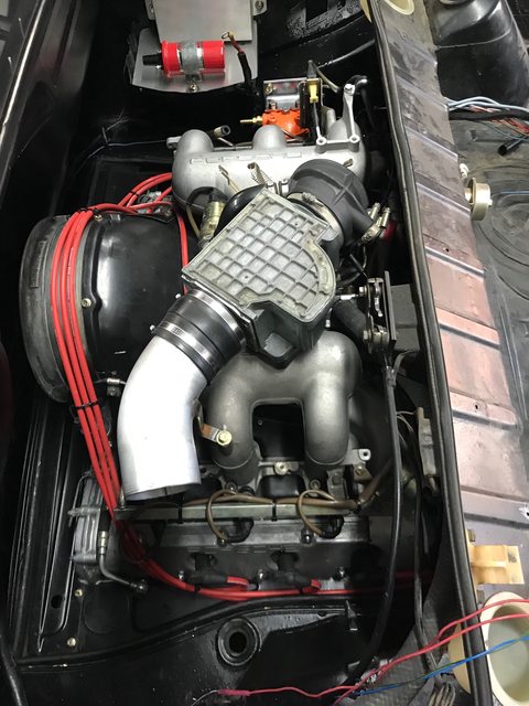

The 3.2 fares a bit better on overall driveability. While first gear is mostly unusable unless you want to gamble, it has terrific torque in 2-4th and would be my first choice for an autocross focused car because the torque and power down low are so usable. Plus, a stock 3.2 needs precious little tweaking (maybe a chip) to achieve decent HP numbers (e.g. 220). Sure you can hop it up to a wild twin plug PMO build, or if you feel especially financially irresponsible, do one of the new ITB/crankfire builds like I saw at the Air & Water EMPI booth, can get even more power. But like a 3.6, a 3.2 build will start adding up fast, and you're having to deal with bigger brakes, better cooling, and potentially chassis stiffening and suspension upgrades. Still, I get why this is a popular engine and I love mine as it lets me do things I couldn't do in my 2.7 (whether I should do them is another question).

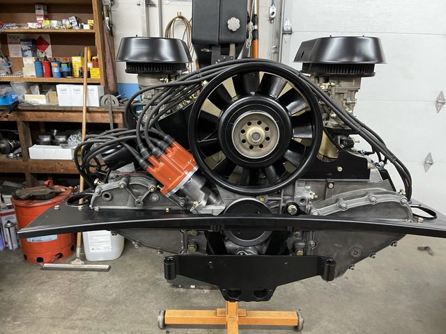

Which brings me to the twin plug 2.7: with a solex grind cam and Webers (or PMOs) this is such a lovely engine. It absolutely fits the character of an early 914 - it has personality, grunt, it revs past 7k and howls like a banshee all the way there. Below 5k it delivers nice torque even from down low. Driving on twisty roads, it is perfectly happy between 3-5k where it pulls hard out of corners. Yes, it may need additional machine shop work at the outset, but even factoring in those costs, it's still a relative bargain compared to its bigger brothers - and you have lots of choices on cams and pistons to achieve either a nice low to mid torquey motor with a solex cam or a screamer with high compression pistons and S style cams. And with a front oil cooler, shuffle pin and other mods, you won't suffer the ills that the smog choked 75-77 motors suffered. You'll just cry once at the machine shop.
(IMG:http://www.914world.com/bbs2/uploads_offsite/i.imgur.com-21443-1719381165.2.jpg)
Here's why I think a built 2.7 best fits the authenticity of the 914 - Personality! You have to work it to keep up with the bigger sixes but it lets you carry momentum through the turns better, and it sings to you all the way to redline. The main culprit I'm finding is fuel efficiency, as I'm getting maybe 15-16mg whomping it where the 3.2 turns closer to 20 mpg (and the stock CIS can deliver as much as mid 20s). And then there's the extra cost of twin plug setups, which while cheaper than an MFI setup, still add up.

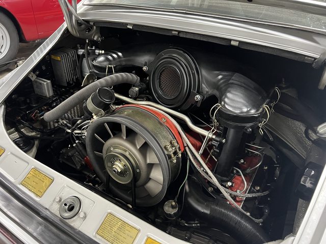

I'm still early days enjoying the RS2.7 MFI build in my 1974 911, but I think even with limited seat time, it's quickly become my ultimate favorite 2.7 for a street car. The payoff of the MFI is immediate acceleration, nearly flat torque through the entire RPM range, with linear power delivery that starts strong and just continues to build. The gorgeous soundtrack and Swiss watch feel of the motor are the stuff of air cooled dreams and I finally understand the love for the 1973 RS2.7 Carrera. Plus you can easily see 230-240hp if you invest even more for a higher compression build (I had seat time in a high compression 3.0 MFI build that bowled me over).
Problem is it's very cost prohibitive to build and MFI engine starting from scratch. Nothing is cheap with an MFI, and it takes special know how to tune and tweak unlike the relative ease of a PMO. Aside from expense, the MFI does punish you with 12mpg average when pushing hard. But if I had only one engine I was able to put in my 914 without worry of cost, the RS2.7 MFI might be it.

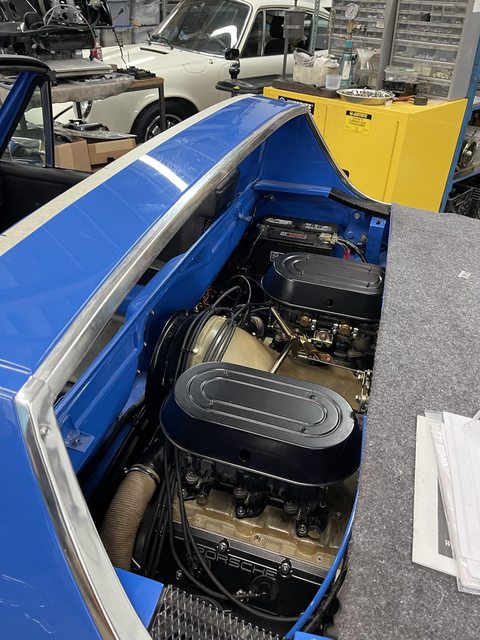

Which brings me to a special 3.0 RSR build that I had the pleasure of getting a brief ride in. With MFI and high compression pistons, it was close to 330hp and had an 8k redline. It was the most glorious sound and feel I've ever experienced in a 914 (and that included a 2.5 short stroke carb'd motor below from the same engine builder that had me salivating the first time I rode along). Both of those cars were track focused cars with license plates, and I wouldn't consider them streetable or livable for day to day. But they were sure amazing and they live in my 914 dreams with their sound and character.

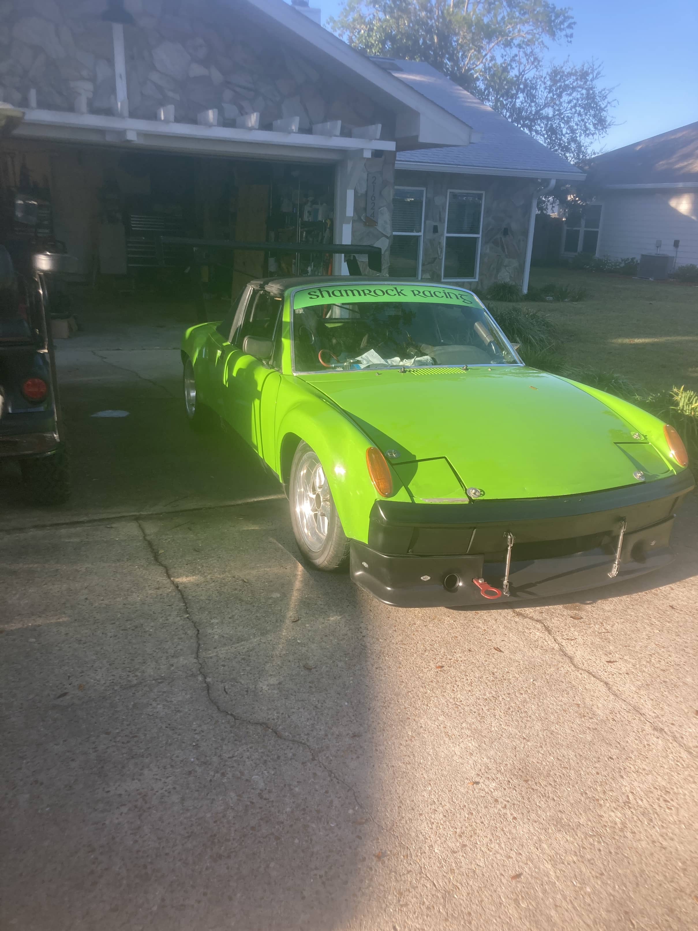

I had a unique experience to compare a few years ago.
Normally ran this guy with a 3 liter with 46s and some other “stuff” but reasonably $$.
Had an issue so switched engines to a carbureted 2.7 so as not to miss a DE weekend.
With the bigger engine I could run down stockish 3.2 911s…..even on the longer straights whereas the 2.7 didn’t give it the long legs needed for speed. Had a 3.6 but decided the $$ for installation wasn’t in the cards…….i could also hurt my 901 with regularity without all that torque.Attached Image
