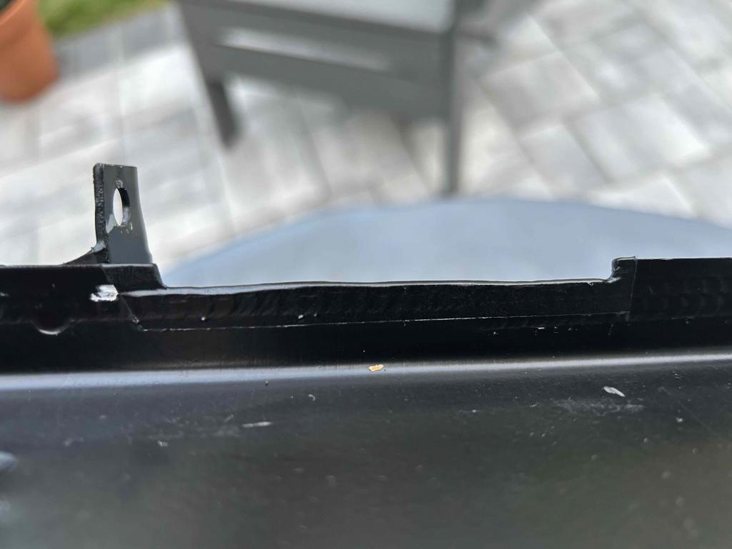

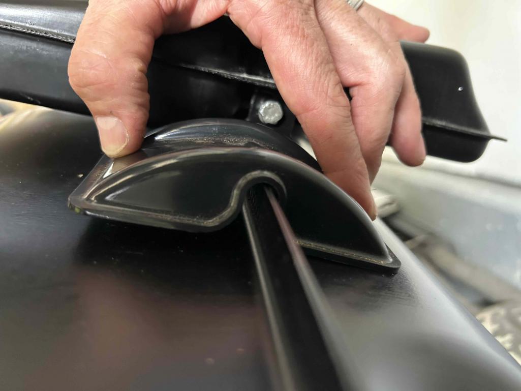

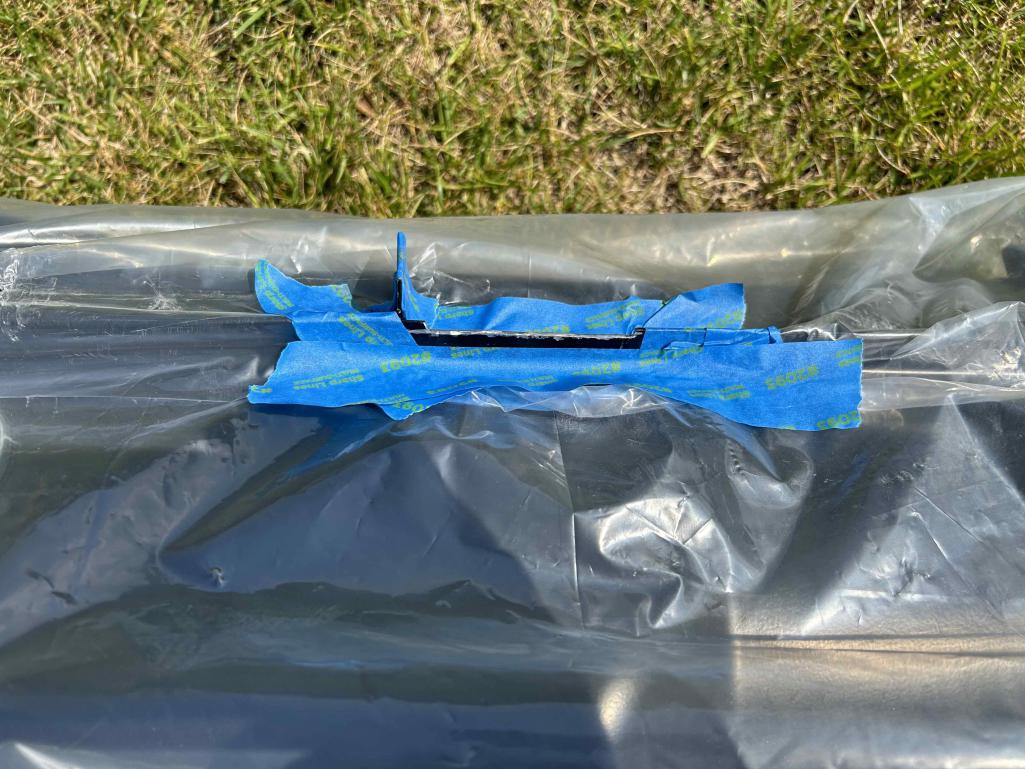

As others have reported, which I was prepared for, the rib/seam is too tall where the tank strap bridge sits. So I'll either have to trim that down or shimmy the bridge.
I cut out the notch, sanded, primed, and painted. Not too hard. Annoying that I had to do that for a new part, but happy to have a clean tank, finally.
