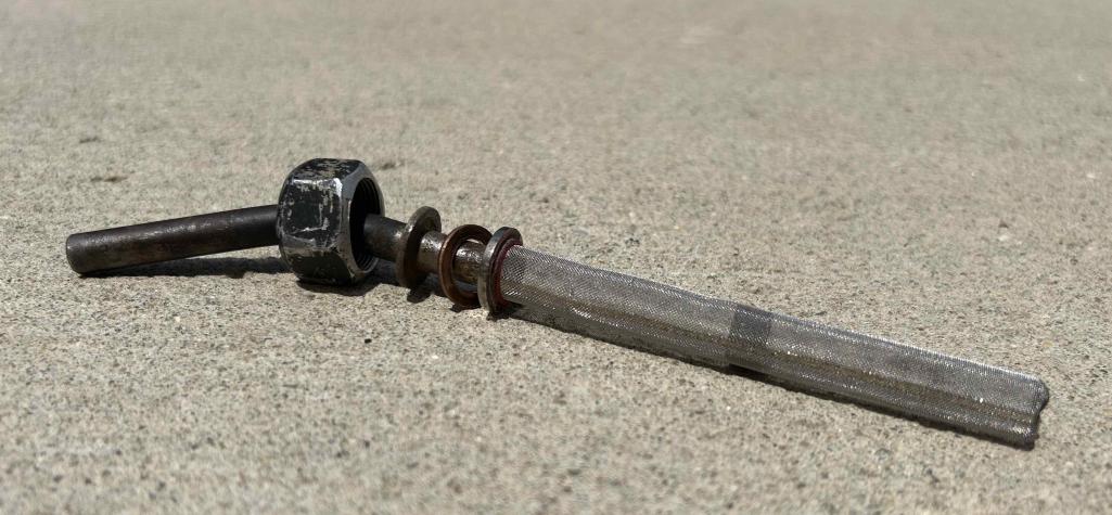

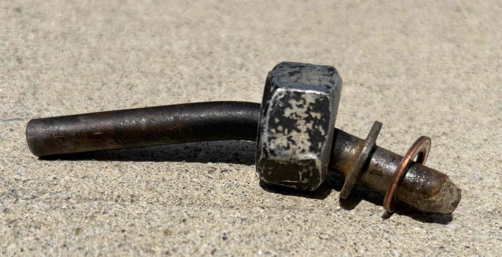

Questions as I dust off the cobwebs from a month ago when I pulled the old tank ...
1. Do I have the order of these pieces correct?
Send pipe:
Return pipe:
2. Can I reuse the copper washers that I bought new from AA that I installed on the original Dansk tank? I tightened them down all the way when I installed them on the original Dansk tank. My fear is leaks by reusing them.

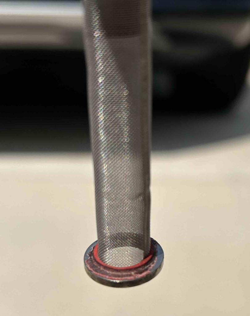

3. I put a new sock on the original Dansk tank, but now I'm worried that the red washer on it is destroyed from removing it on the original Dansk tank where it was tightened down fully. I need a new washer/seal here, right?

DC_neun_vierzehn   The replacement Dansk tank arrived today. Shout ...   Jun 26 2024, 10:22 AM
Superhawk996   Just baffles me how Dansk can’t be bothered to a...   Jun 26 2024, 10:32 AM
DC_neun_vierzehn   Questions as I dust off the cobwebs from a month a...   Jun 26 2024, 10:35 AM
Superhawk996   Copper work hardens when you tightened the fitting...   Jun 26 2024, 11:20 AM
Jamie   Copper work hardens when you tightened the fittin...   Jun 26 2024, 12:06 PM
Superhawk996   These dumb OEMs . . . Constantly putting parts on ...   Jun 26 2024, 04:02 PM
