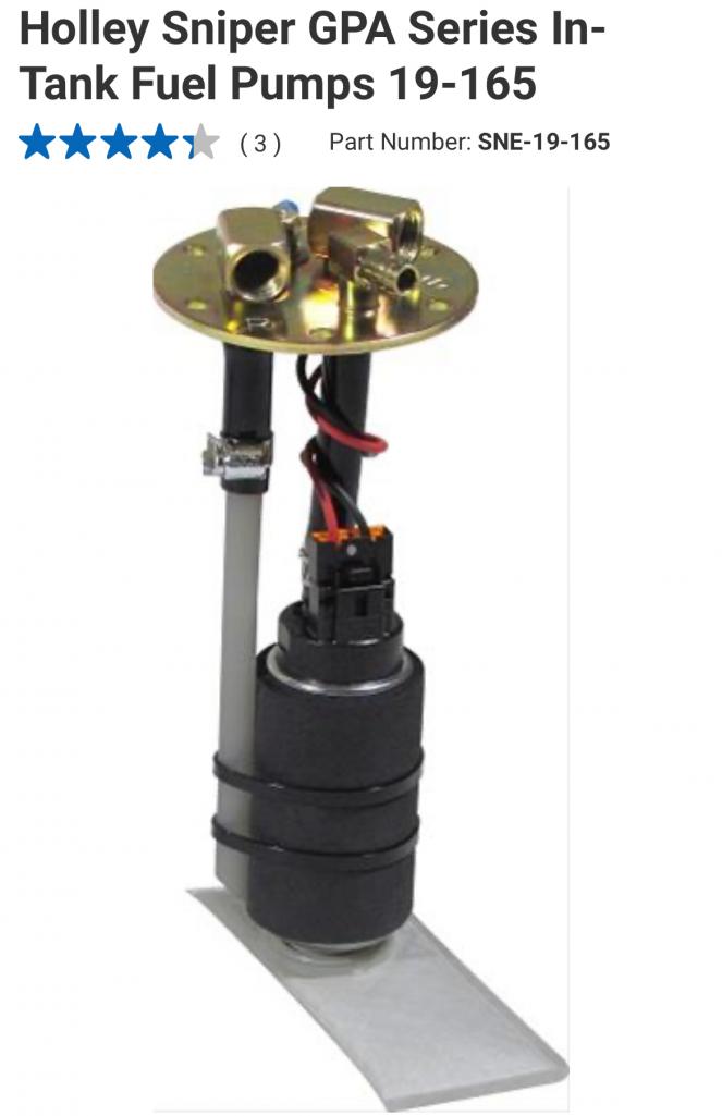

As always a picture is worth a 1000 words.
Modern in tank pump still has a mesh sock at the inlet.
50 odd years of development. In tank pump uses the fuel in the tank to cool the pump in addition to the fuel running through it. The pump is at the very bottom of the tank to maximize fuel pick up. All fine filtration is done on the high pressure outlet.
The surface area the inlet sock has been increased vs. 914 which is a good thing. However massive contamination would still clog the inlet sock. As a side point, it’s worth nothing that modern plastic tanks have eliminated the tank rusting issue that lead to OPs need to replace the tank in the first place. Lots of good stuff has been learned since the late 60s.
