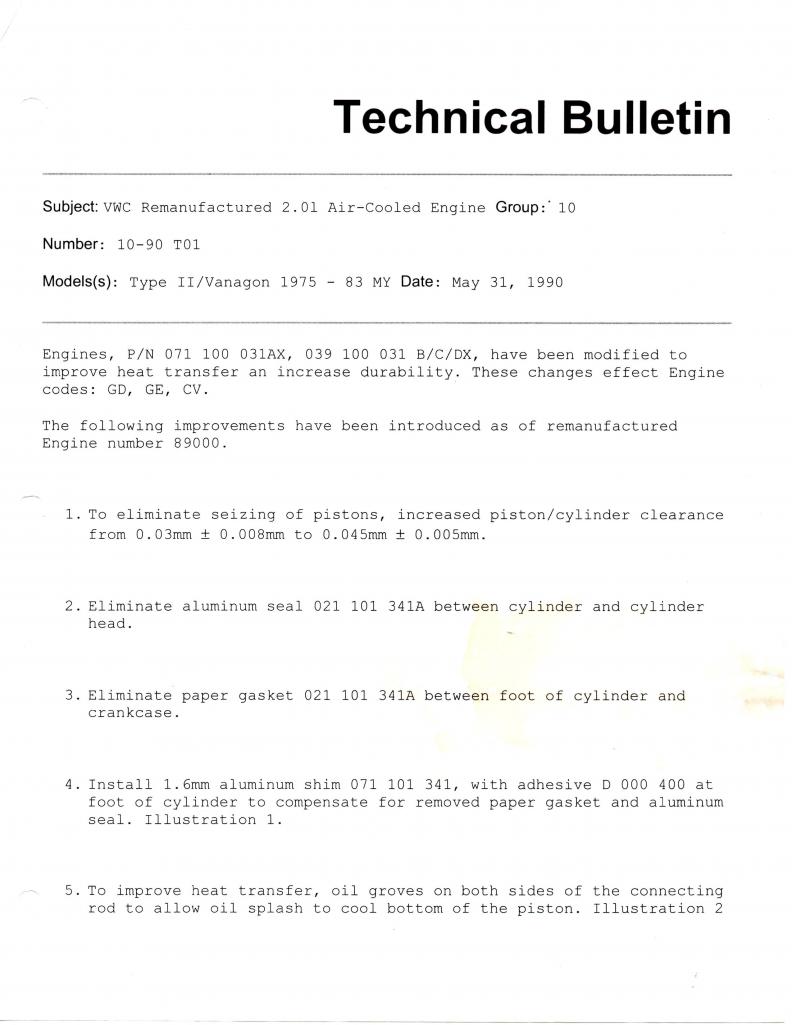

I stayed up last night reading a bunch of articles about type 4 rebuilds by Jake Raby and FAT and KB pistons and Mark Stephens,Len Hoffemen in Dune Buggies and HOT VW and VW TRENDS . Everything I read does not use head gaskets in their rebuilds. All are very clear about a .040 clearance . I have built several 2056 with carbs and have not used head gaskets . I have a 2056 in my 912E and a 1911 in my 914 all at 9 to 1 CR and never had a problem in 15 years of use . We need Jake to comment on this subject.

The only time to use the factory T4 head gaskets- is NEVER.

914werke   BTW #5 should be performed on ALL T4 builds (usin...   Jun 18 2024, 12:11 PM
930cabman   BTW #5 should be performed on ALL T4 builds (usi...   Jun 18 2024, 12:17 PM
914werke   correct. Poor mans oil squirter!   Jun 18 2024, 12:18 PM
rick 918-S   Question: The update states improvements were mad...   Jul 2 2024, 06:54 AM
