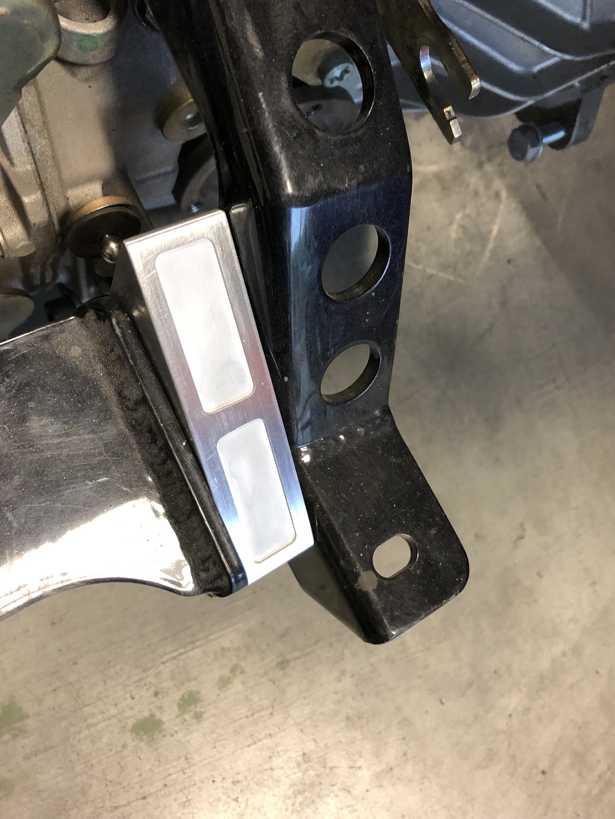

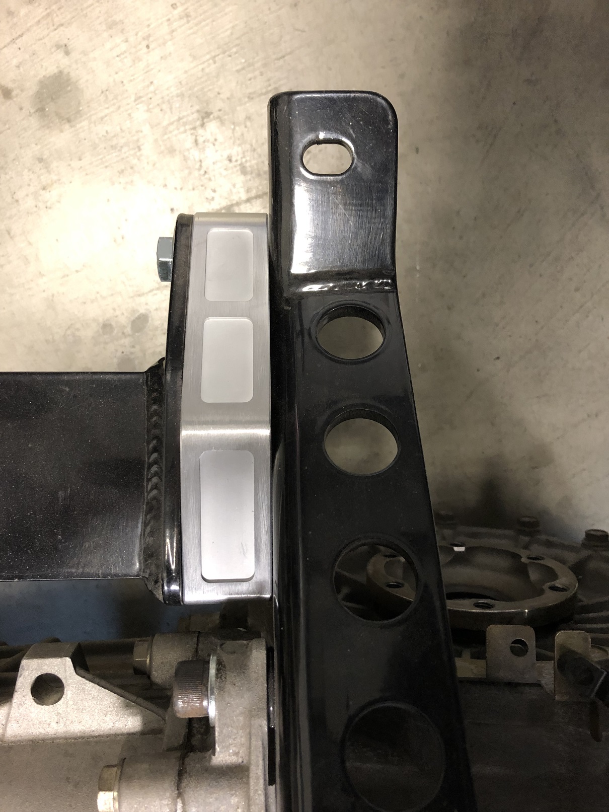

@Lof8 Here you go. A chunk of aluminum that was shaped to fit between the Renegade mount and the extensions that bolt to the 914 trans mount.
Let me know if you'd be interested in them.

tygaboy   @Lof8 Here you go. A chunk of aluminum that was s...   Jul 2 2024, 03:16 PM

Lof8   @tygaboy that is nice solution that I hadn’t e...   Jul 3 2024, 04:43 AM
tygaboy   @[url=http://www.914world.com/bbs2/index.php?show...   Jul 3 2024, 06:52 AM
Lof8   @tygaboy Your spacers could be exactly what I nee...   Jul 3 2024, 07:02 AM
tygaboy   @[url=http://www.914world.com/bbs2/index.php?show...   Jul 3 2024, 03:50 PM
Lof8   I’ll reach out if 1.5” ends up being my magic ...   Jul 3 2024, 06:27 PM
