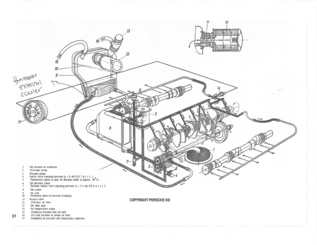

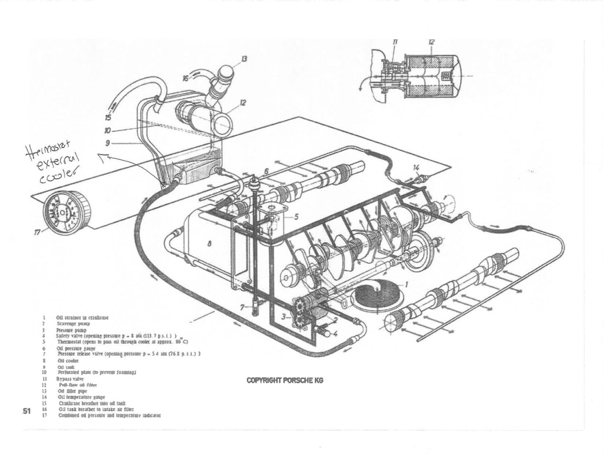

IronHillRestorations   @930cabman check your oil lines. Sounds like you ...   Jul 7 2024, 09:08 AM
930cabman   [b]@[url=http://www.914world.com/bbs2/index.php?s...   Jul 7 2024, 11:58 AM
mate914   [b]@[url=http://www.914world.com/bbs2/index.php?...   Jul 7 2024, 12:22 PM
sixnotfour   the bypass for the oil filter is in the console ,,...   Jul 7 2024, 09:13 AM
sixnotfour   top right,   Jul 7 2024, 09:23 AM
mb911   What console do you have? I have seen reports on t...   Jul 7 2024, 09:46 AM
930cabman   What console do you have? I have seen reports on ...   Jul 7 2024, 11:57 AM
930cabman   What appears to be some sort of pressure valve ins...   Jul 7 2024, 02:35 PM
mb911   What appears to be some sort of pressure valve in...   Jul 7 2024, 02:47 PM
930cabman   Been wrenching for 50+ years, never seen an oil fi...   Jul 7 2024, 03:20 PM
sixnotfour   is this an oc 54..not the early filter.   Jul 7 2024, 03:51 PM
930cabman   is this an oc 54..not the early filter. If memo...   Jul 7 2024, 03:56 PM
sixnotfour   is this an oc 54..not the early filter. If mem...   Jul 7 2024, 04:00 PM
rudedude   Other 911 owners have had issues with oil filters ...   Jul 8 2024, 11:00 AM
mb911   Other 911 owners have had issues with oil filters...   Jul 8 2024, 12:02 PM
930cabman   [quote name='rudedude' post='3155381' date='Jul 8...   Jul 8 2024, 01:35 PM
mb911   [quote name='mb911' post='3155387' date='Jul 8 20...   Jul 8 2024, 01:46 PM
technicalninja   Seeing no oil at all in the filter would bug the c...   Jul 8 2024, 02:10 PM
930cabman   Seeing no oil at all in the filter would bug the ...   Jul 8 2024, 03:10 PM
mb911   http://forums.pelicanparts.com/porsche-911...oil-f...   Jul 8 2024, 02:23 PM
930cabman   http://forums.pelicanparts.com/porsche-911...oil-...   Jul 8 2024, 03:19 PM
930cabman   https://mahle.integrityplatform.org/ Wonder if th...   Jul 8 2024, 03:24 PM
mate914   https://mahle.integrityplatform.org/ Wonder if t...   Jul 8 2024, 06:24 PM
930cabman   [quote name='930cabman' post='3155427' date='Jul ...   Jul 8 2024, 07:00 PM
