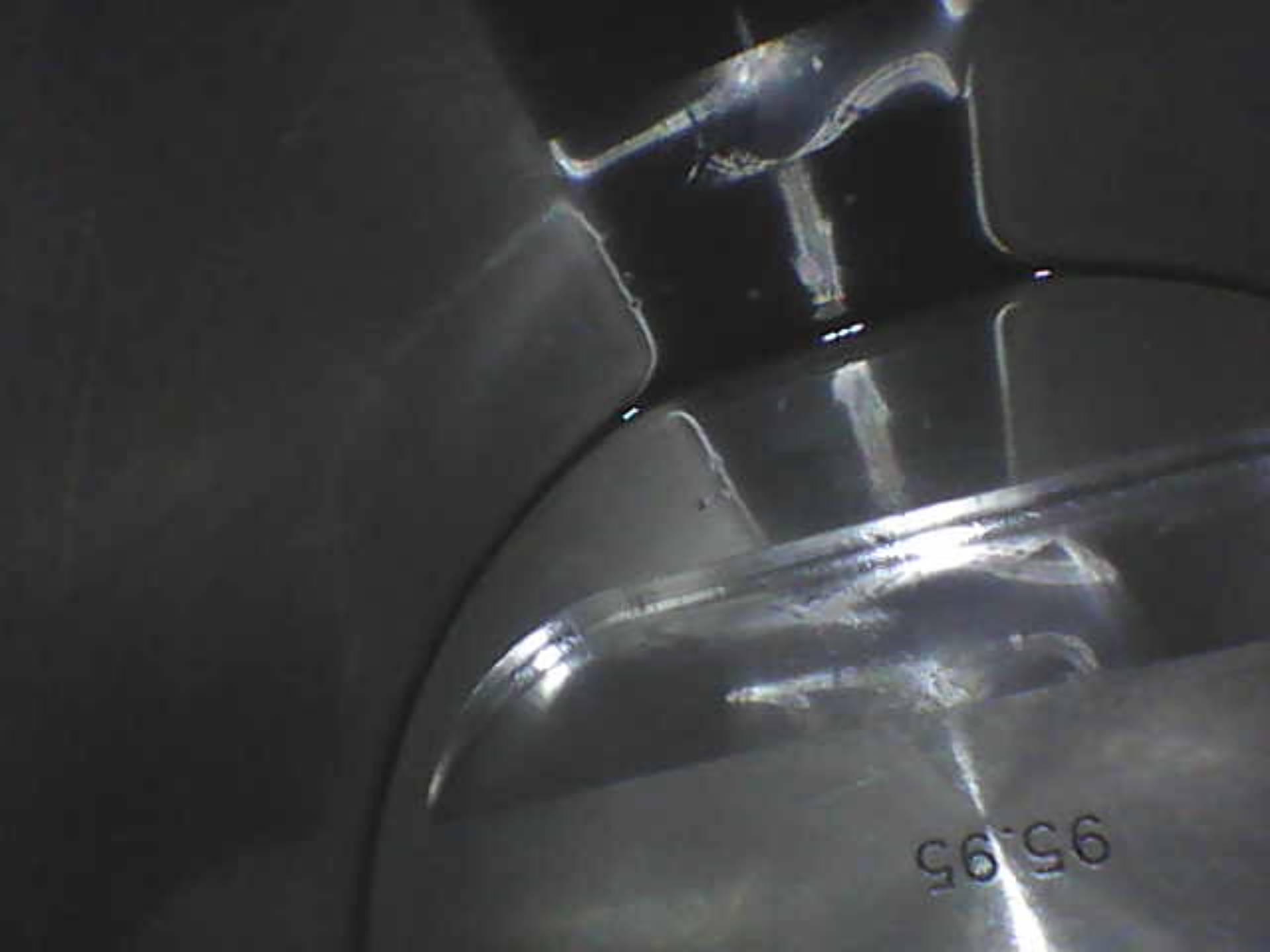

Boroscope just showed up. Pistons are marked 95.95 on top. They are flat with valve relief cuts. Any idea what pistons these are?

emerygt350   They look like my 96mm pistons. If that thing is ...   Jul 8 2024, 04:19 PM

technicalninja   I DON"T like the raised 95.95. I want the to...   Jul 9 2024, 07:09 AM
Robroe   I DON"T like the raised 95.95. I want the t...   Jul 9 2024, 03:57 PM

emerygt350   I think the raised numbers are just an optical ill...   Jul 11 2024, 05:53 AM
technicalninja   95.95mm in a 96mm bore equals .05mm PTW clearance ...   Jul 11 2024, 07:26 AM
Superhawk996   95.95mm in a 96mm bore equals .05mm PTW clearance...   Jul 11 2024, 08:10 AM
Robroe   95.95mm in a 96mm bore equals .05mm PTW clearance...   Jul 11 2024, 11:33 AM
