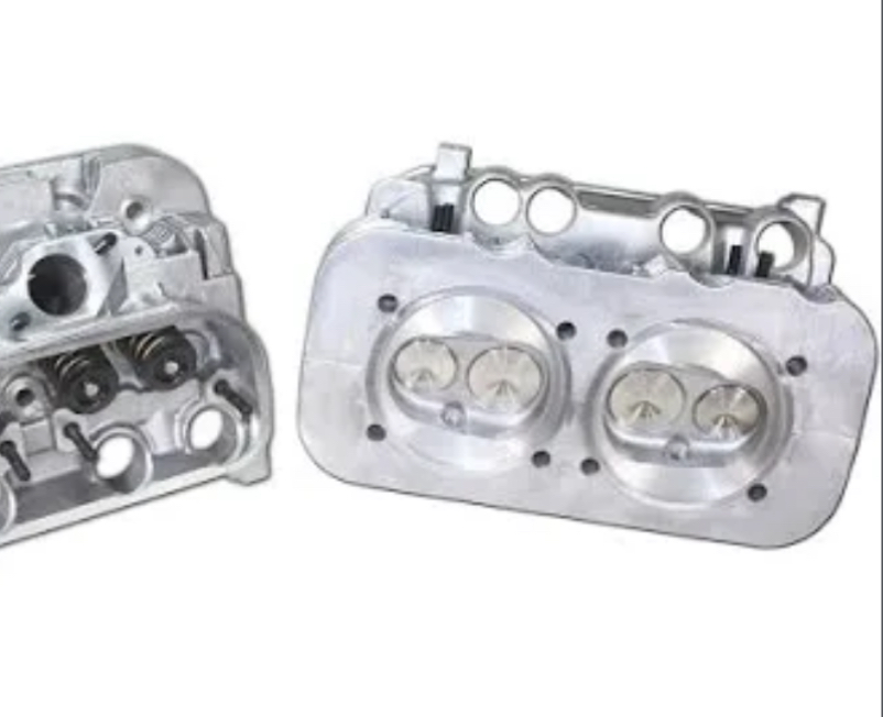

Have 73 1.7 bought in pieces. Engine has been rebuilt and ‘souped up’ however I don’t know what internals were installed. New crank, cam, pistons, rods and heads. but I don’t know which ones. Weber 44 idf carbs. Never had oil in it and been stored unstarted for 10 yrs in climate control. I’ve added oil by slow dripping 2 quarts through the oil pressure sensor hole. Oil dripped out of the rockers so I’m pretty sure it got some oil as pre lube. It’s on a home built test stand with the transmission mounted with the starter.
I’m trying to turn the engine over by hand with the plugs out. Have squirted oil in each plug hole. I’m able to turn the engine by hand about 45 degrees and it gets harder to spin so can’t go any further. Would it be a good idea to pull the rocker arms to see if the builder installed some wild cam without checking valve/piston clearance? It doesn’t feel like internals are hitting each other but who knows? Would hate to pull the heads if I don’t have to. Any thoughts before I break something?

Dude not even close to perpendicular to the dome of the piston. Especially on 1.7L heads. I don’t have a set of heads in front of me to measure but probably almost 45 degrees on 1.7L heads.
Geometry matters.

emerygt350   First of all, looks like 2.0 heads to me. Cylinde...   Jul 10 2024, 06:56 PM
Robroe   First of all, looks like 2.0 heads to me. Cylind...   Jul 10 2024, 07:15 PM
Robroe   First of all, looks like 2.0 heads to me. Cylin...   Jul 10 2024, 07:17 PM

technicalninja   Positives: Heads- look like Raby heads with weldin...   Jul 10 2024, 07:26 PM
