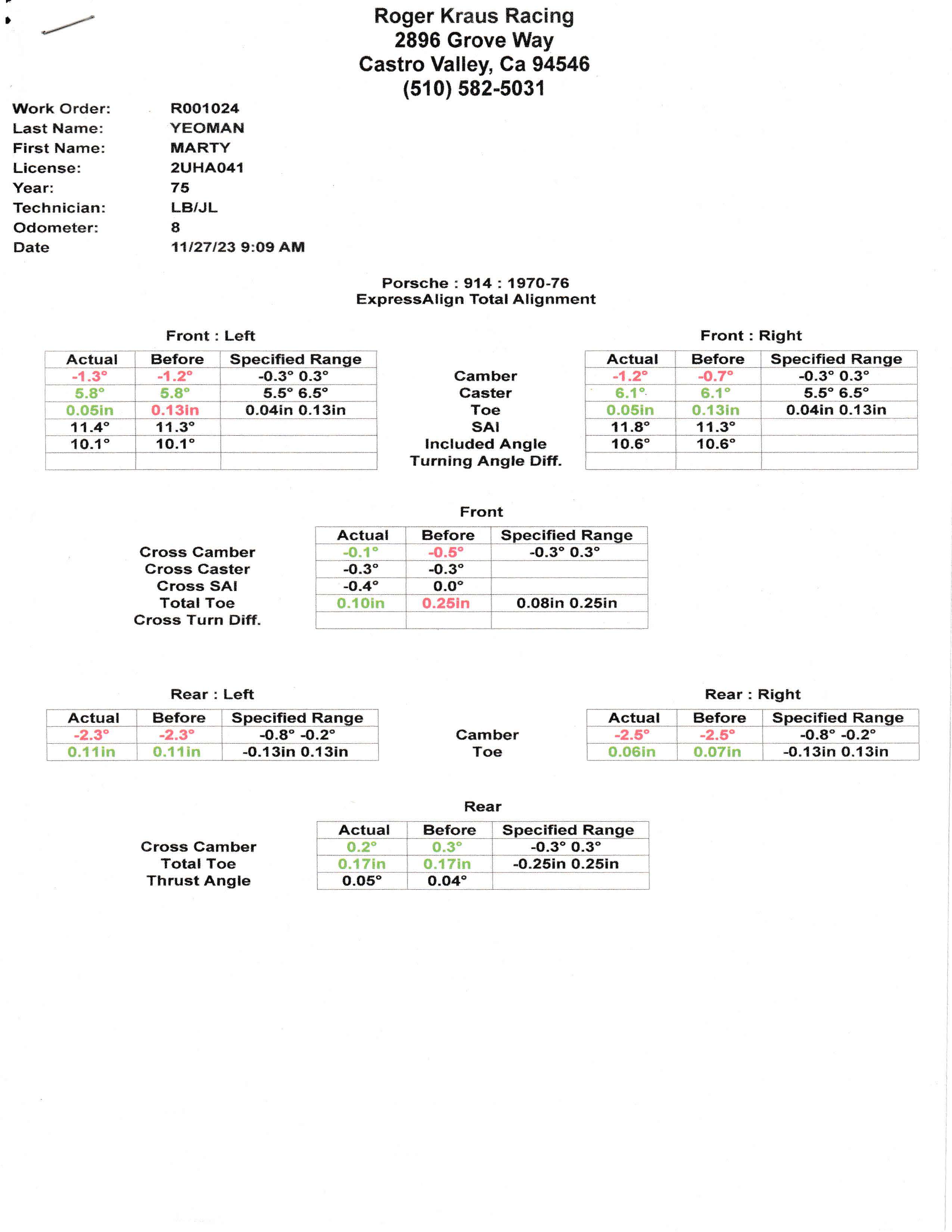

1975 1.8 fully stock California car. I just put in turbo tie rods as well as a new trailing arm bushing, so alignment was needed. Not easy to find shops that do alignment on these cars, but a local member recommended a racing shop about 30 miles away and I took it there. They asked if I wanted it aligned for "street driving" and I confirmed that was the case. Let me emphasize that this is a stock California car in well maintained condition (a previous owner had it for 44 years and really took care of it) and I'm a really mild street driver. It is rare I'll use every one of the 76hp this can put out (IMG:style_emoticons/default/biggrin.gif) . Street driving only, no AX, no racing. It drove fine getting to the shop, no pulling, no vibration, etc. They told me it drove "much better" after alignment, and that the alignment was way off, especially in the rear. I couldn't tell any difference in how it drove pre and post alignment, but remember I drive for fun and I'm not by any means an aggressive driver. I brought a bunch of 914Rubber sourced shims with me, but they needed none of them and in fact returned to me a bunch of shims that were already on the car. I didn't notice it at the time I got the car back, but the next day I could see the rear wheel stance was significantly different, with (in my opinion) a lot of camber. Prior to the alignment it had maybe 1-2 degrees of camber. Again, I can't tell any difference in how the car drives, but maybe I could if I really pushed it? My question is, is this correct? I've really not seen this amount of camber on other members cars. Also, I kind of hate the rear tires leaning inward look. Not sure if I should take it back and ask for this to be "corrected." Other options are to live with it, or take it to another shop. Any thoughts? Is this amount of camber correct?
MartyYeoman
post Jul 9 2024, 09:01 AM
Posts: 1,559
Joined: 19-June 03
From: San Ramon, CA
Member No.: 839
Sorry to hear you're having such a difficult time with Brandon over at Roger Kraus. I've used them twice over the years with what I would consider excellent results. First time was to setup an unknown condition car to be a commuter/spirited twisty road car. Lowered with spacers at the steering rack. The thing handled like on rails after I got it back. Very pleased. Second time was to just validate specs as it had been multiple years (15+) and I'd just replaced all four tires. The alignment had held surprisingly well. Tire wear has always been a concern but never been a problem. I've always run Summer/Performance tires and yes the rears wear more on the inside but the setup seems worth it. No complaints. Tire wear was never unacceptable even when I used the car as my daily driver/commute car. I'll attach the spec sheet from my latest visit. Brandon was the alignment tech both times.

MartyYeoman   Sorry to hear you're having such a difficult t...   Jul 9 2024, 09:01 AM

MartyYeoman   Sorry it took so long to post this.   Jul 20 2024, 12:11 PM
